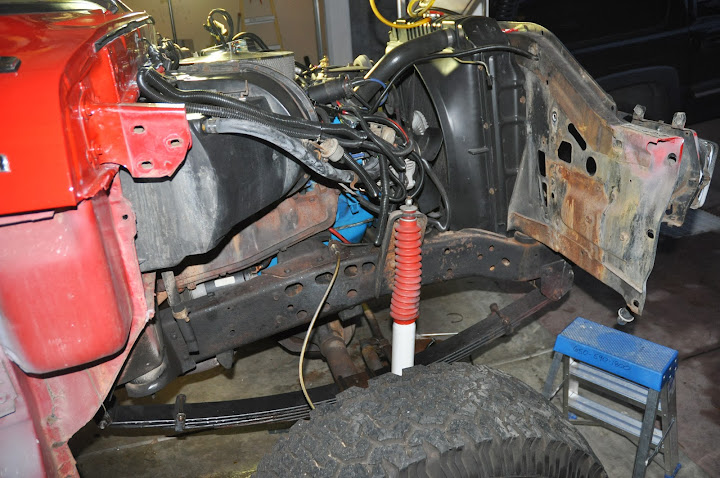

Progress today! I got all the panels removed and the steering gear box. Goal accomplished! Tomorrow I will give the engine compartment and frame a sponge bath and get everything cleaned up for paint.
Here's the not so pretty pictures but the end result will be great!
Getting the day started.
Table staged with most of the new stuff. Still waiting for some steering parts to come in.
Nice thing about TV work. Really nice lights to use for working on our trucks.
A little dirty but Zero rust! I'll get this cleaned up tomorrow.
Steering box removed.
Right side is a little cleaner. Not bad for a 35 year old truck.

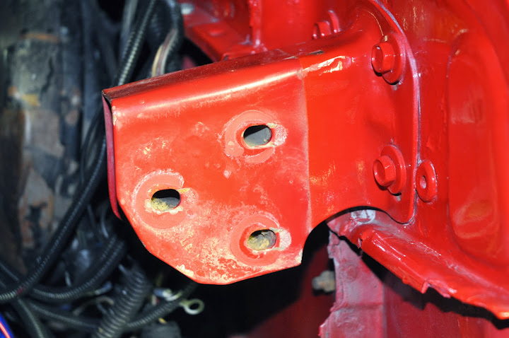

Here's my inner panels ready to go to the powder coat guy (Once he returns my call) I found one small crack under the Main battery tray but since it's galvanized I'll make a small patch for it and rivet in place.
Here's my lower steering shaft bearing. It's toast. Replacement on it's way.
Main battery tray has some corrosion, I'll probably fix and paint it and call it good as I won't find one better at P&P.

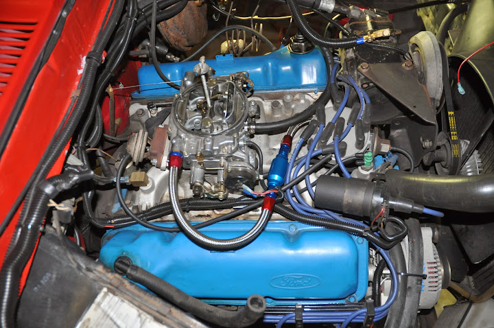

Today was a little bit slower pace. I had some family stuff to take care of so that took some time. I got the fuel system done and the new Red Head bolted up and everything attached except the steering shaft. I still need the lower bearing. I also washed the radiator support and firewall. Cleaned up really nice. One thing I noticed was the paint color difference between the original Candy Apple Red and the new Candy Apple Red. I heard that Ford had changed the color sometime in the 80's and this seems to confirm this.
I still need to neaten up the hose routing with some brackets that I will fab at my shop.
Cleaned up firewall. I think I'll use Turbohunter's idea and use blue heater hoses and a new air cleaner.

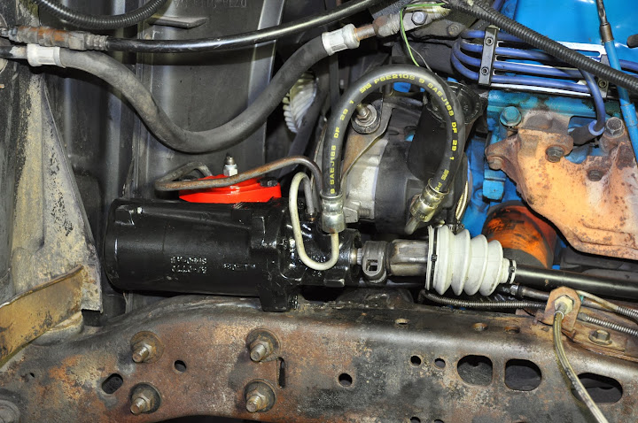

Here's my weak point. I don't know front ends and differentials very well and I would welcome input. Removing the top steering arm from the top of the king pin I got a lot of slop from the lower king pin. After looking at how the top one was designed I figured out that releaving the tension on the spring loosened up the lower tension as well. School me if I'm wrong. It kinda freaked me out at first having so much wobble but I would have noticed it last week when I drove it.
I haven't tried getting the bolts out yet (One came out with the nut) but I did soak them with PB Blaster and I'll give them a try later this week.
It's back to work this week, I hope to have some time off so I can do some little things before or after work. Despite looking rather naked I think Candy Cane is looking pretty good and will look real nice under the hood when completed. Time to put the tools away for the night and watch 60 Minutes.

Yes you are correct on the lower bearing. You should place a jack under the lower kingpin cap then remove the top bolts/studs. Same when going back together. Just make sure to place the steering at full lock in the tightening direction when torquing the studs/bolts. Good time to re grease everything as well.

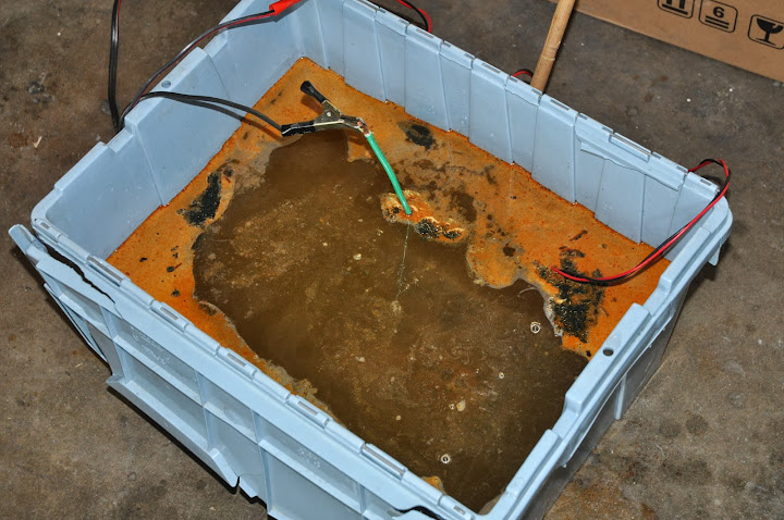

Today we did Science! Electrolysis to remove rust from my original battery tray. It's real easy.
One rusty part.
One tub of water mixed with washing soda with an old brake rotor as an anode. We placed the rotor on the bottom and used plastic spacers between the battery tray and the rotor. Tomorrow I will flip over the battery tray and do the other side.
A good friend to help stir the pot!
We added wires to the anode and the battery tray to keep the clip leads out of the solution and ensure a good contact.
Hook up the leads, plug it in and watch Science in action!
Since we have time to spare (Not really but we like to play) I hooked up a temporary web camera so I can monitor my soup and be at ease knowing I'm not blowing up the shop. Yes we have ventilation fans running all night for safety.
I know its a lot of photos for such a simple thing but the cool factor dictated a write up. More later guys (and gals)!
