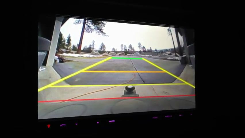

I recently installed a Kenwood DNX-9990HD head unit and a CMOS-310 backup camera. The unit was super expensive so I found a factory refurbished one for half the sticker price.
It's got just about everything you would want in a deck short of multiple disc. CarToys wanted almost $3k installed. I did it for under $1k my self using the refurbished deck and a brand new camera both off eBay.
I want as much room as I can get for storage and a sub takes too much room up. I wont be adding or switching any speakers out unless they are broken. What I did instead was bought an $8 can of aerosol spray in bed liner and sprayed it on the inside of the door panels behind the speakers where you would put dynomat. IMO it works as good as dynomat because you can get into corners and over tubes better. I had an 86' Cutlass that had only 200W worth of subs in the trunk and it sounded like 1000W+. The entire body (inside) and frame was sprayed in bed-liner and it made a world of difference. Also, I've had a ton of aftermarket speakers and nothing seems to sound as good as stock with bed liner. Aftermarket gets way louder, but doesn't have the richness unless you go with a true High Mid Low system.
If you want to do an amped system you want to pat attention to the voltage on the pre-outs. You want 5v or more. Cheap and intermediate decks usualy have 2v. The higher the voltage on the outputrs the cleaner the signal your speakers will put out.
You can also have the backup camera where the movie is in this pic.

I don't think I mentioned it has built in Garmin.
I've set it up so I can watch video or backup camera while driving.
It has multiple angles to deflect glare too.
