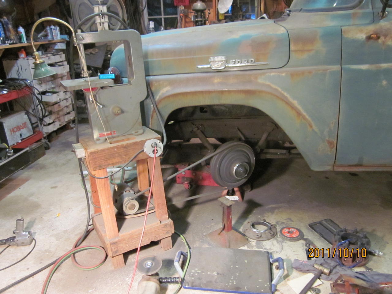

This is for the F350 version... '53 to '66. Maybe this isn't appropriate for your F4 because you said five lug. I didn't see how to post a photo on a pm. But if you want to convert to an 8 lug modern rim, this is what I did. I cut off my six lug F350 flange with an angle grinder. I had the hub spinning from an electric motor from an old bandsaw as seen in the photo. Cut with a cutoff wheel on a 10" angle grinder. Used a 'toledo adapter' from wheeladapters.com. It bolts to the 8 bolt on 6.5 pattern that holds the brake drum, after you get rid of the old school 6 lug flange. This should be done by a machine shop, but mine came out fine. 65 mph, no vibrations down the road like a magic carpet ride. Anyways here's a couple of pictures of what some say isn't possible. I later welded the remainder of the hub to the toledo adapter, JIC.

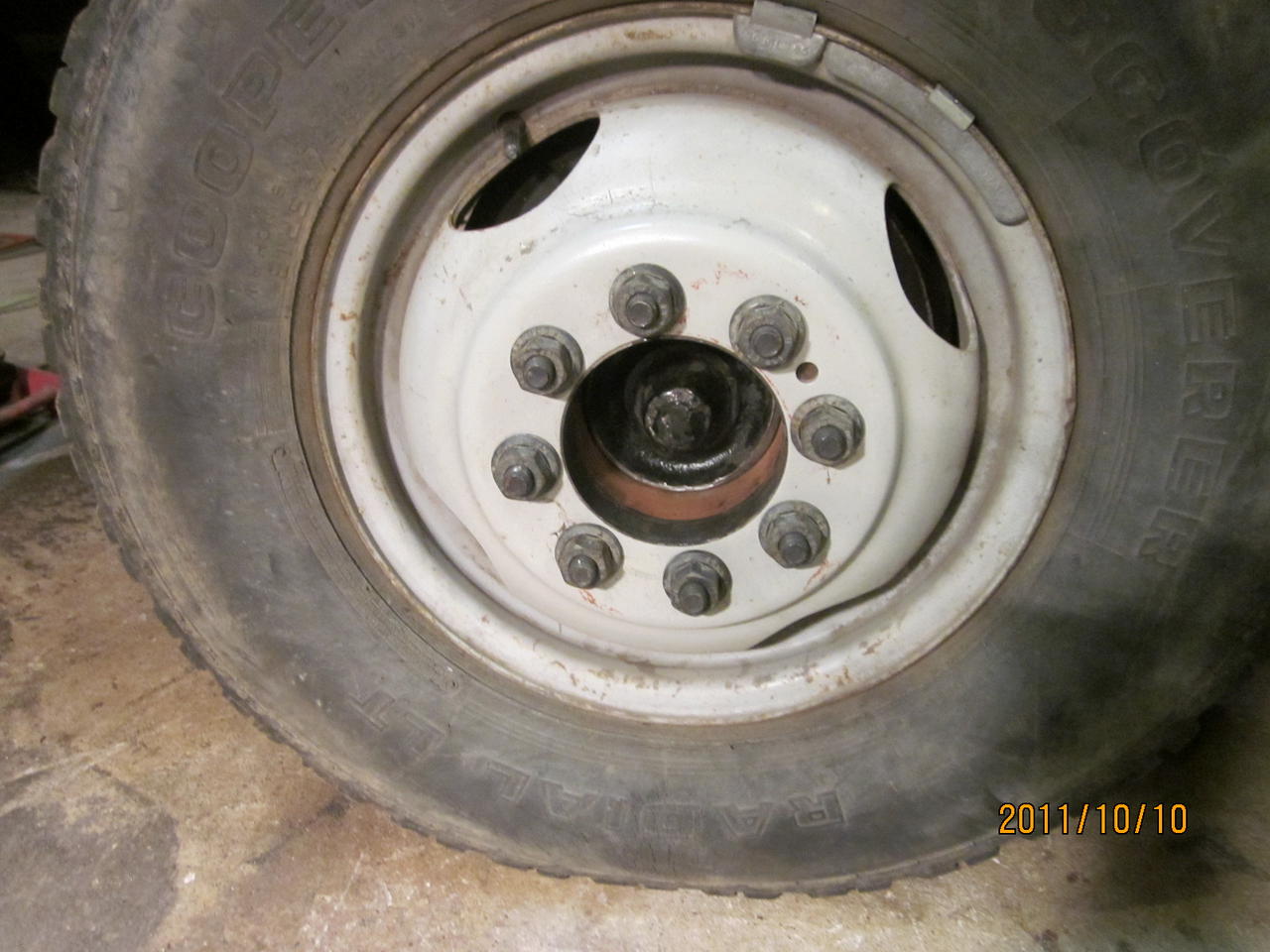

Here's a picture for others who start with six lug. Somewhere there is an 8 lug hub that fits your 5 lug setup....

Ray, this looks like the adapter on my 49 hauler, mine doesn't look quite as deep as these but may be, still haven't been to the garage, Garry

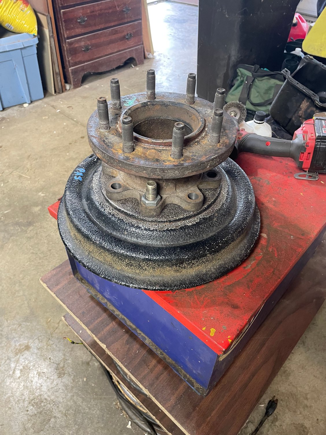

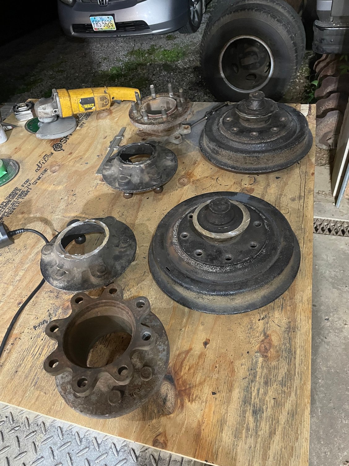

I’m sure I posted this info someplace else (mostly sure lol). But I ended up doing this six to eight conversion to my 55’f350. Only difference was my spacer/adapter were from a I believe second gen dodge dually.
I will admit I thought long and hard before chopping my hubs. But so far everything seems to be just fine. I’ve put several hundred miles on the truck and had it running 65mph with no issues.
I also swapped the rearend at the same time. I used a cab and chassis rear from a 96’ dually with 4.10 gears and limited slip. This gave me the same 8x6.5 bolt pattern front and rear. Then dressed her up a little with some aluminum Ford wheels made by Alcoa.

Thanks GB. I’m not gonna lie, I spent a lot of time staring at the hubs before I finally chopped them. It’s hard doing that to a part that you know is extremely hard to replace.
But in the end, I couldn’t be happier. Truck rides great (its still barn door pushed down the road), and is much more user friendly.

You nailed it on the head. Was actually gonna have a buddy who’s a machinist do the work. He backed out because he didn’t wanna screw up an obsolete part. So me and a six inch angle grinder went to town
