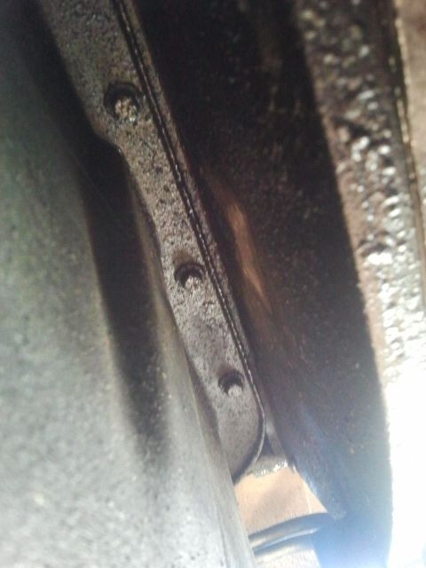

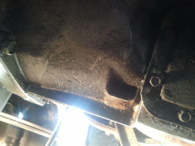

Here is the bottom of mine . I dont have anything like a checker board
patteren
I looked for anything oval shaped and can not find anything it is just solid metal

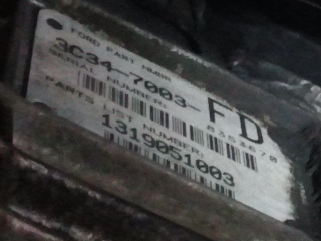

Here is the plate I found on the side of my transmission

You can just bite the bullet and buy a replacement transmission from Ford for the bargain basement price of $3791.33 minus $600 if you return your old transmission for a core credit from here as well:
https://www.tituswillfordparts.com/c...n=3C3Z-7003-FD

With an automatic transmission you must have access to the torque converter to bolt it to the flex plate. Nothing in the bellhousing has to be bolted up when installing a manual transmission, so I wouldn't expect any access plug.
