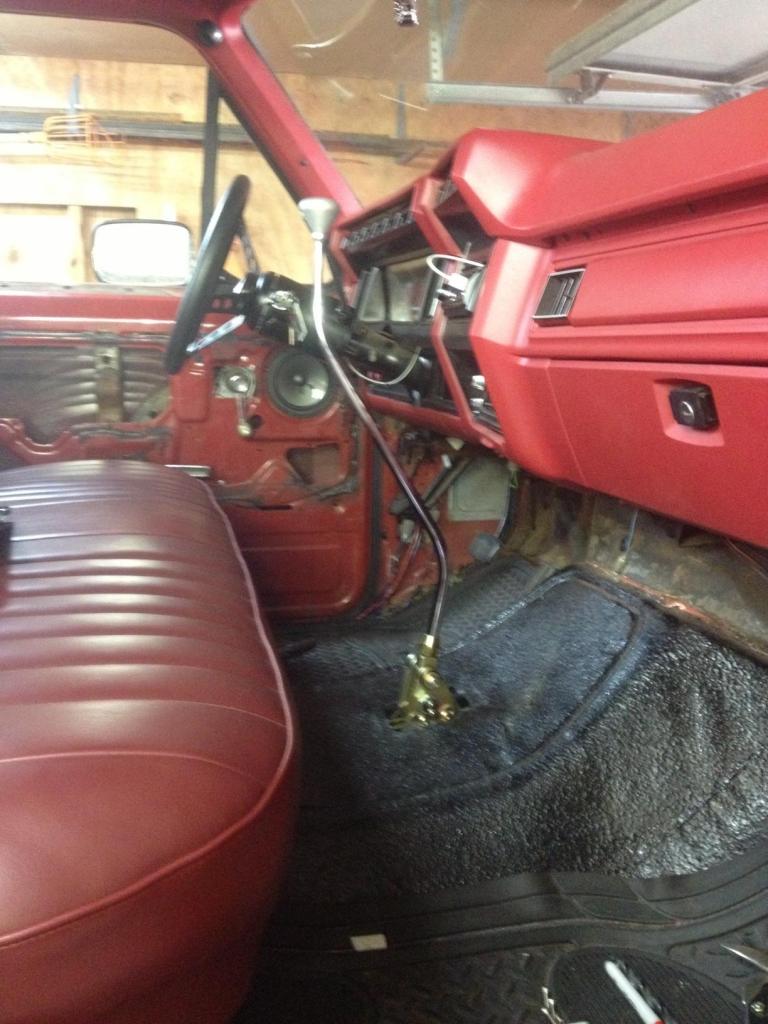

Now for a little customizing....when we pulled the motor I couldn't seperate the shifter linkage so we cut it and I decided to install a Lokar shifter kit

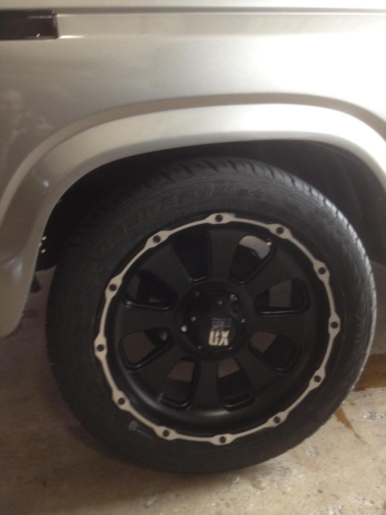

The stock 15in wheels weren't cutting it so went with a nice set of XD

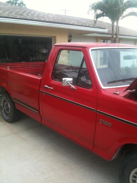

Here is the truck when I first got her

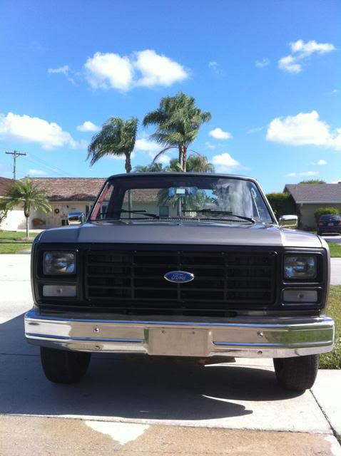

After the body shop

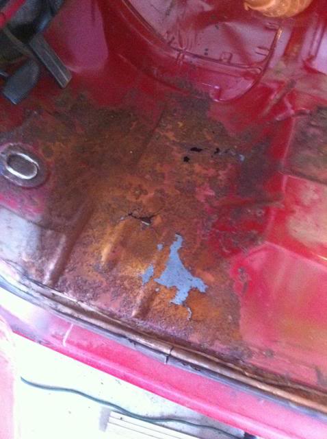

Edit: How hard was the floor to do? Mine is rusted out similarly and the corners are gone and there are dings. So, I'm weighing cutting and welding vs swapping cabs as I have a solid cab as a donor or replacement.
