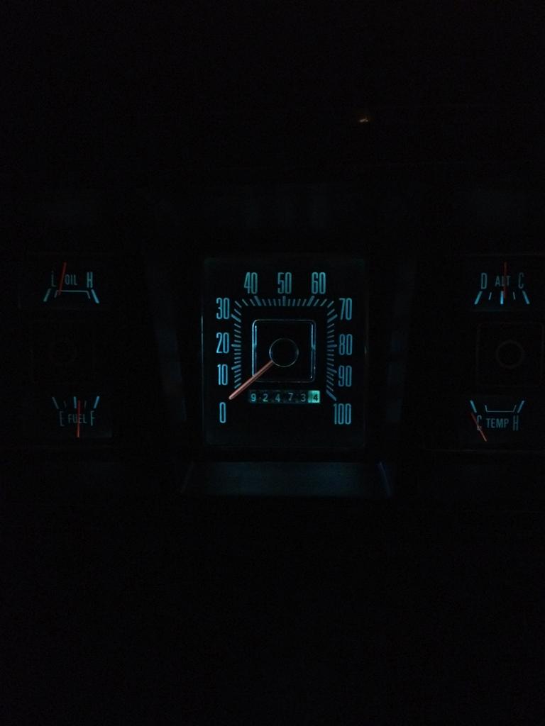

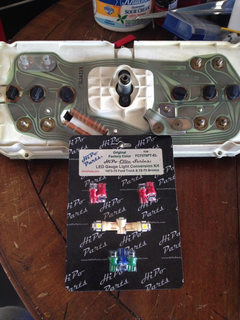

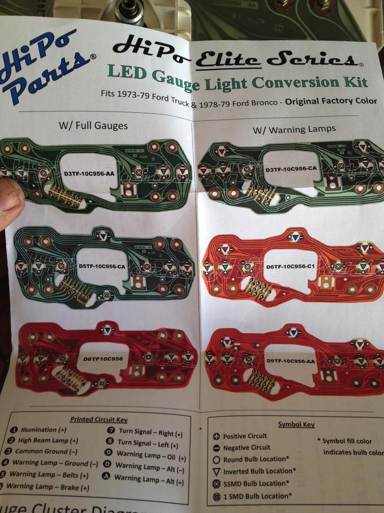

Ok, just got finished installing the HiPo Parts LEDs in my dash.
It could not have been any easier.
Over all impression is favorable, not ecstatic, but favorable.
The gauges are brighter and the light is much nicer and readable, which after all is what I was after.
It's probably not what you guys that want color are looking for. But us older guys will like it.
The dimmer function is very good. Just like stock.
Here is the kit.

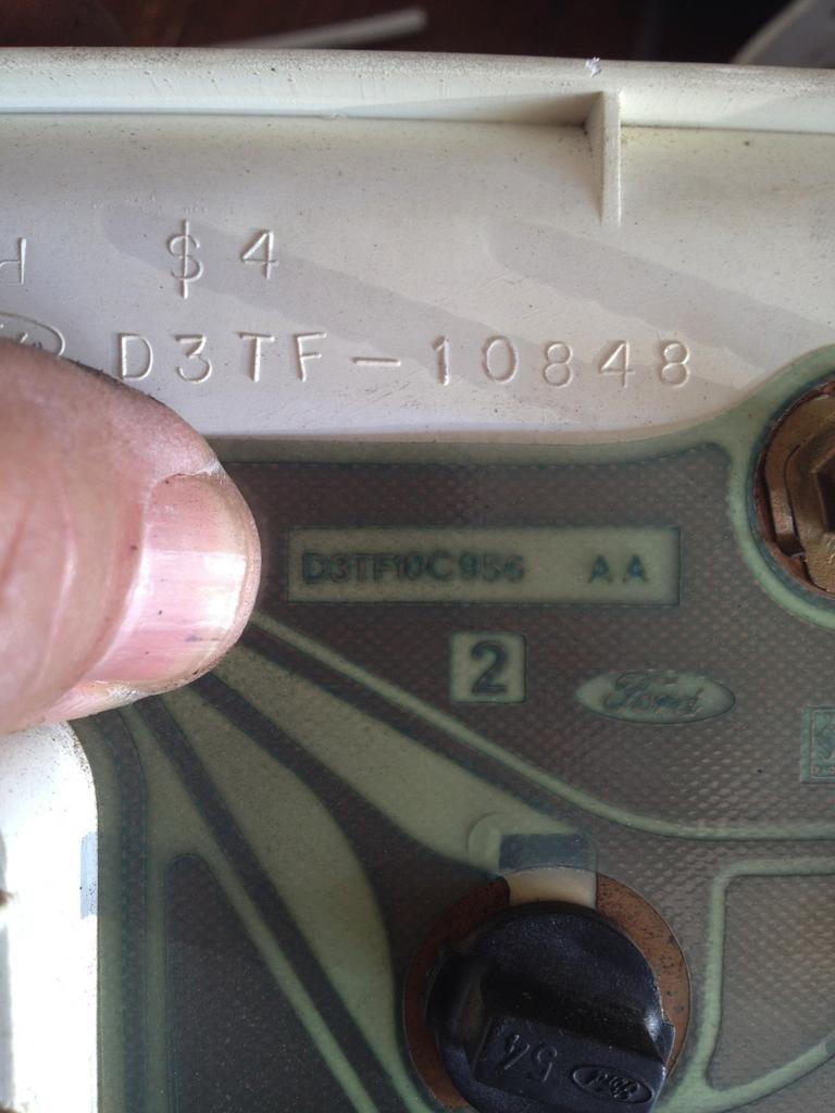

Just match your part number up with the appropriate drawing and stick 'em in.

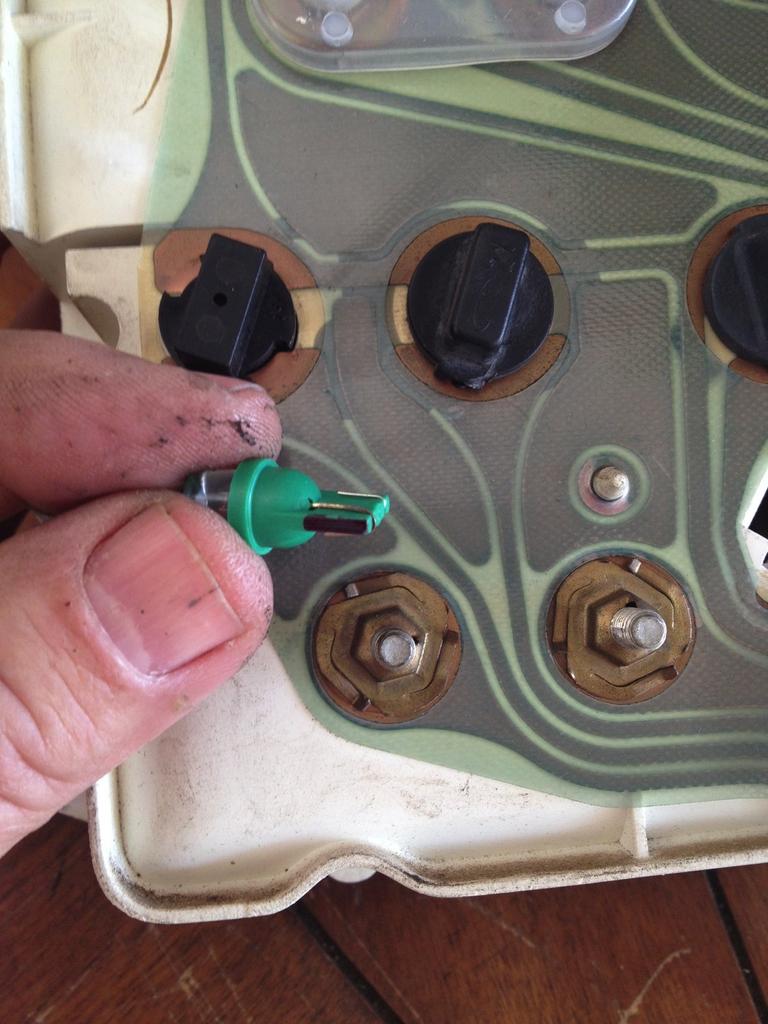

Each bulb is marked on the positive side.

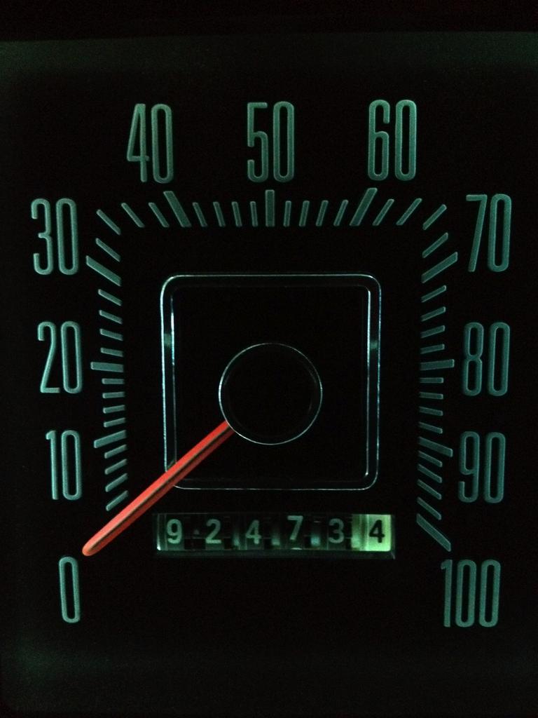

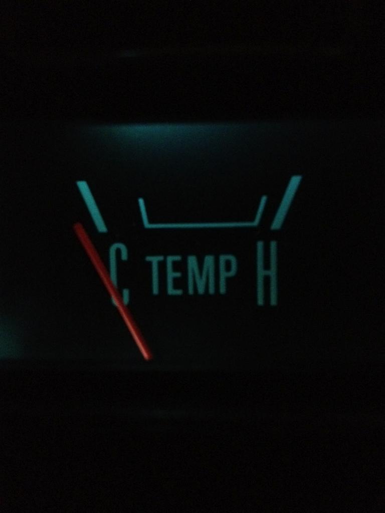

Here's how it looks. The pics obviously don't do it justice but I included them so you could see that while not BRIGHT, they are brighter.
BTW, my turn indicators are now beautiful. Instead of looking like the gel was burned through, they are even and deep green. And bright.
