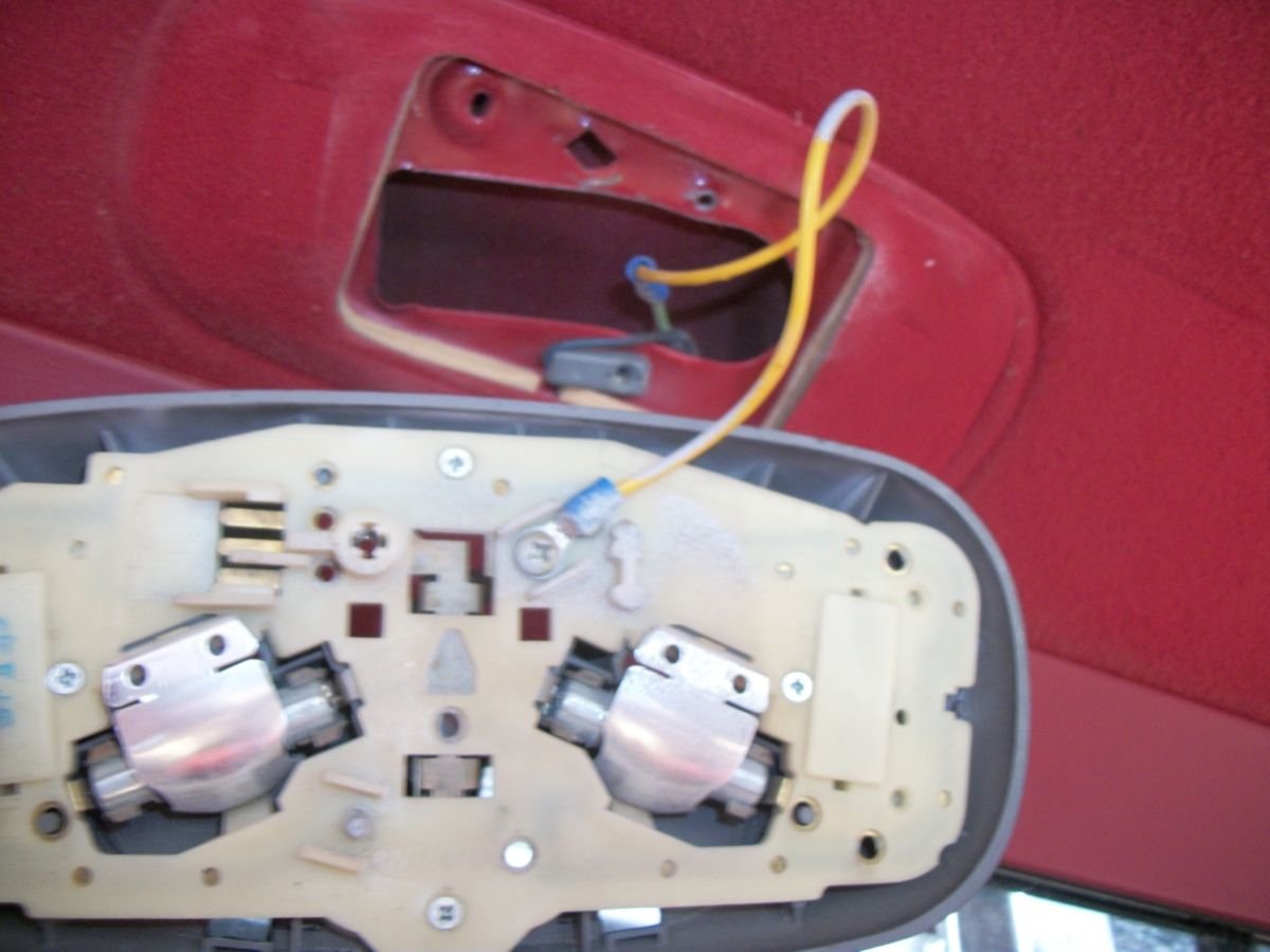

You boys are trying way too hard. What some of us do, is toss those old horrible dome lights and grab something from a more modern truck or car and swap the whole thing. Much improved interior lighting for just a few bucks.
Oh, it looks like I retained the ground plastic, for simplicity but you know, you can just make your ground rather than frig with those. Just grimp on some ring terminals and or fish a devoted ground wire up there and butt connect it.You don't need to use what was cheap and most efficient to use on the assembly line, to get a ground to your light.

Well, this is great, I appreciate the wiring picture. But I still need screws to put it back in place. I have a functioning dome light, I just need to be able to install it.
