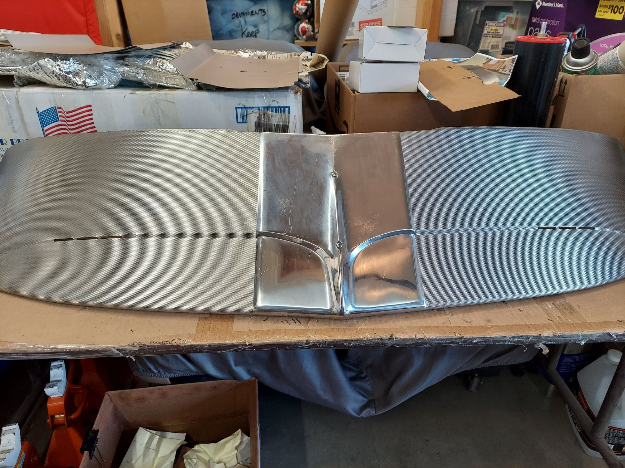

I am using a Comet Sky Shield from the 50s. Had to shorten it and make brackets. Using riv-nuts in the body of the cab to mount it. Don't know of any made specifically for the F1. Not that hard to modify a 3 piece visor.
Hope this helps
Dan
