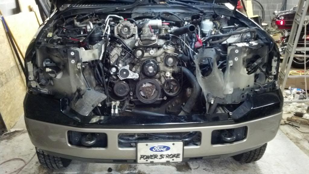

Here is where I am after a couple of hours of messing around.
Old Oct 30, 2012 | 08:02 PM
MisterCMK's Avatar
MisterCMK
Joined: Mar 2003
Posts: 24,724
Likes: 74
From: Blue Hill Township
Did you pull the glowplugs?

Old Oct 30, 2012 | 08:14 PM
BLADE35's Avatar
BLADE35
Joined: Apr 2010
Posts: 19,060
Likes: 238
From: Saratoga Springs,UT
Looks like pullen the moter regaurdless
