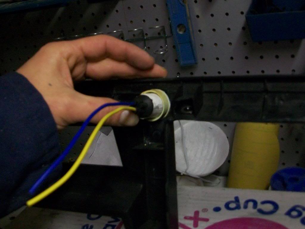

So I saw that my gauge cluster post was added to the DIY Fun section of a sticky thread so I figured I'd up date what I did with my turn signals.
......and of course it doesn't stop there. From where I disassembled thefactory cluster, I had to do something with the turn signal towers I kept. Whatif they got inserted into the trim surround.....wouldn't that rock. Well here'sthe pics from the journey I took trying to do this.
Here's the turn signal towers I took to fab into the trim surround.

Here's the jest of what I'm trying to do....front back views ect.

After some fiddling with it, it started to look like something:

It’s not quite done yet, I still have hours and hours left of detail sandingbefore final paint. I’m hopin to get it all finished up and installed in the nextfew weeks. Once it’s all together I think it’ll look sweet…….
