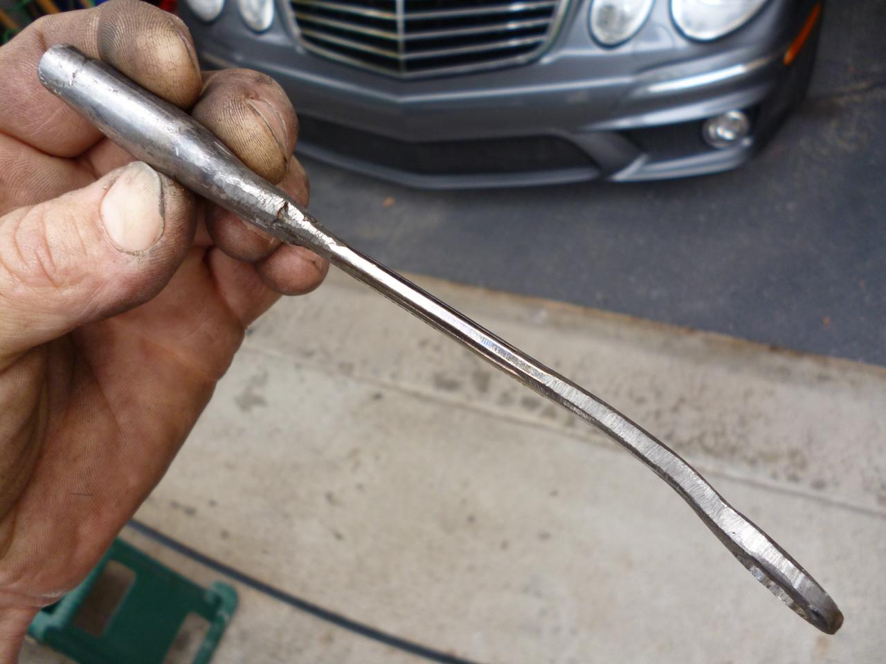

Rollin, you might want to make yourself one of these!
Name:  IP wrench profile.jpg
Name:  IP wrench.jpg

Yep, those three bolts that hold the IP to the housing need to be loosened. The two lower are kind of tough access. I was able to get it with a normal wrench, but it is tight. I guess it depends on your wrench.
Once loose, engine off, rotate the top of the IP toward the passenger side to advance.
