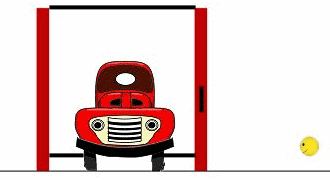

You idea looks doable to me but I'd reinforce the heck out them. Not to be offensive but the skates and stands look like Harbor Freight specials so there won't be any loss if you modify them. I'd start by welding the stands to the skates. Then I'd weld a larger 1/4" plate to the top with four holes that will accept tow U bolts that would fit snuggly around the axles, or square U bolts if you plan just to use it to move the frame.
I think you'd still have to be careful while moving it around if you floor isn't smooth and flat so one doesn't caught in a crack. If you make them beefy enough and rigid, no other parts other than the wheels pivoting, I think they should work. Also, as long as you kept the vehicle low to the ground when moving it. I wouldn't it as high as you and then try to move it.

Good idea. I've actually seen something close to that in use and it seemed quite stable. Great drawing as always!
