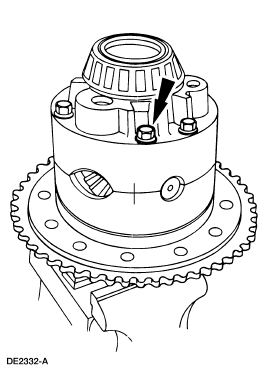

hey guys im doing a diff service and dont know if i have trac lock or not?? how can you tell by looking at it. I do have the additive so if i do end up with having trac lock then im set

You can tell, visually, by the diff case when the cover is off. It will have the bulges in the case next to the bearing for the clutch lugs.
