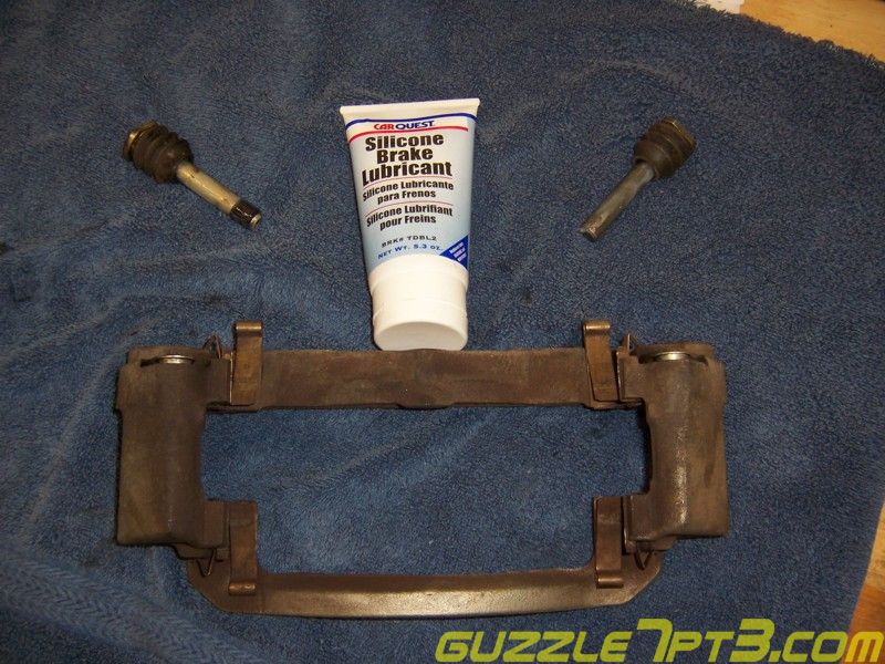

Originally Posted by Powerstroke-7.3
My driver side front rotor is rubbing on the springs that the outside pad sits in upper and lower.
I'm sorry, but I don't understand this. You're talking about an uppper and lower spring the brake pad sits in? Are you talking about one of these items?

yes the items to the left

Those should not ever touch the rotor. Are they installed like this?

Can you see a shiny spot where the rotor is rubbing? If you look at the picture above, you'll notice those spring clips do not extend inside the slide pin bracket, so the rotor would have to rub on the bracket along with the clips if that's where it's rubbing.
The slide pin bolts are not loose are they?

the rotor rubbed the part of the clip off that hooks on the iside of the bracket. the slide pins feel fine i actually felt they were too dry so i lubed them but didnt over do it.
