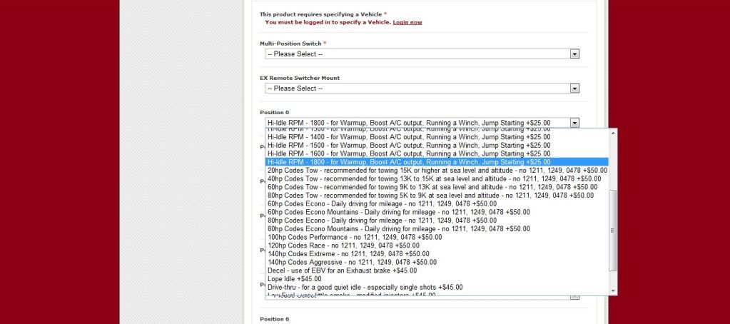

anybody have a list of all the available tunes? i didnt find one on DP....

Did you look at the drop down boxes? F5 1-16 Position Switch on the fly Chip - Chips - Tuning - 1994.5 - 2003 Powerstroke 7.3L - Ford Powerstroke

nah i didnt see that, thanks
