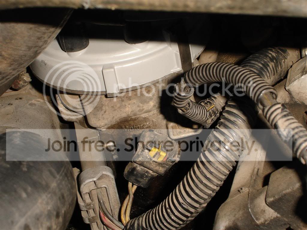

The SPOUT is a small grey plug in the wiring to the distributor that disables computer control of the timing. If the plug is in place, the timing will jump around erratically. Looking at the timing with the plug installed is a waste of time. You have to remove the SPOUT to get any meaningful timing information.

As Andy indicated above it's the plug that enables the computer to control the timing. With the SPOUT connected the timing will vary. If you have set the base timing to ~10* with the SPOUT in then you have severely retarded the base timing. Pull the SPOUT then set the base timing, then re-install the SPOUT.
Your SPOUT connector may look something like the plug on the distributor connector below:
courtesy of oldfuelinjection.com
Or like this:

Ok I see the SPOUT that we're talking about. Mine looks like the 2nd pic. I have never touched this plug at all ever...right now there appears to be a resistor plugged into it. I have no idea where Im suppose to plug it back into once i set the base timing.

Pull the grey plug out, set timing, put grey plug back in.
