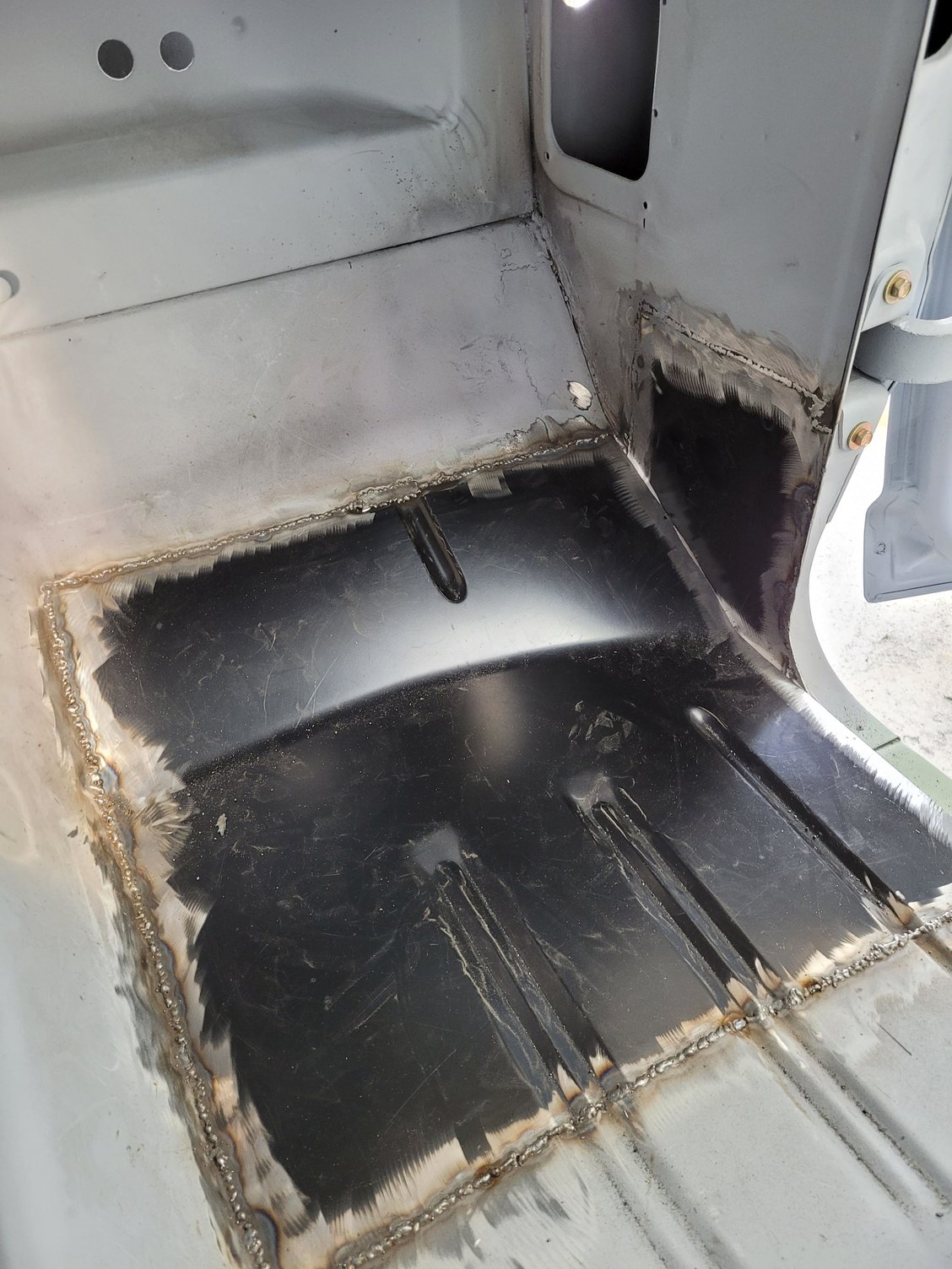

Old Jun 2, 2023 | 04:13 PM
  #37
dkj313's Avatar
dkj313
Joined: Aug 2016
Posts: 320
Likes: 158
Not the best welder but a great grinder
