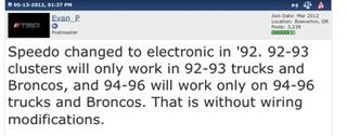

To quote from a week or so ago, and confirming what was mentioned several times much earlier in the thread I believe, these are the compatible ones without a re-wire:
Originally Posted by Diesel_Brad
NO.
92/93 are compatable
94/95 are compatable
96/97 are compatable
It's pretty straightforward. Those listed are the only ones. If you go out of that range, such as trying to use one that's two years different from yours, it needs work to make work.
So yes, your '92 and your '93 are compatible. I just did it on my '92 F150 using a tach cluster from a '93 Bronco.
Completely plug-n-play.
Paul

Another way to confirm is to go by the part number. If it's an "F2T..." part, and the one from the '93 is also an F2T, they're literally the same thing. Your tach wire is already part of the harness.
If it's an "F4T..." it's not compatible. Just adding this because I've seen vehicles mis-marked in junkyards and even sometimes registered incorrectly if they were either very late, or very earlier builds right at a model year change.
I can't remember the exact engineering numbers, but I think they were listed earlier in the discussion too.

The compatibility has nothing to do with model ie 150/250/350/F-Superduty which is why that isn’t mentioned. The only thing you cannot use is a diesel cluster in a gas and vise versa. The tach and warning lamps are different.

It doesn’t specify because it is the same part. That is why it just says “trucks and Broncos”. The only thing that is different is noted in the second picture because in 1997 the light duty F-250 was based on the new F-150 and is a completely different platform than the HD 250 and F-350.
