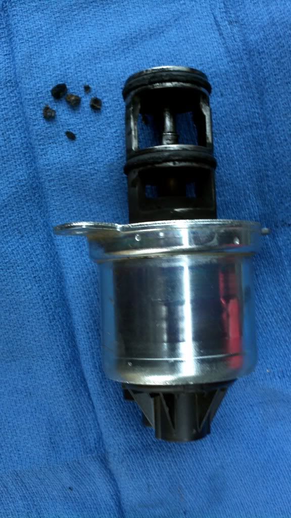

finally here it is
[/IMG]
The smallest chunk (up top) is about the size that was hanging the valve open. I know a lot of you probably don't really care, but I haven't come across a post actually illustrating this so here you go. Besides, now I've figured out to upload photos and post them. The other chunks were actually one big piece that I broke to see what the composition was. I sprayed some seafoam on them to see if it did anything. Also, some gas spilled on them in the back of my truck (gas can for the generator got loose back there). Neither the seafoam or gasoline had any effect on the chunks as far as breaking them down.

Thanks for posting your picture billbot... I think this issue develops if you have an EGR valve that starts to clog and doesn't allow enough exhaust gas to pass thru the EGR Cooler and intake so it builds up additional soot/carbon. Then when the EGR is cleaned and/or replaced exhaust gas can flow at a higher rate and then breaks off the built up carbon in chunks.

Thanks. Hopefully thats all it is. I truly do think its just the nature of the beast, and needs cleaning from time to time. Some get away without cleaning. My truck doesn't get the exercise it needs so I'm sure that doesn't help. Good luck with yours.

Reps Giveen to Both You Guys for the Pics as they always help others
This could possibly explain my case. I cleaned my egr valve about 1k ago and started having problems with it. pulled it out tonight and there were chunks of soot keeping the valve open, and plenty more large chunks inside the manifold. I cleaned and put it back in we'll see how long it takes to fowl up again.
