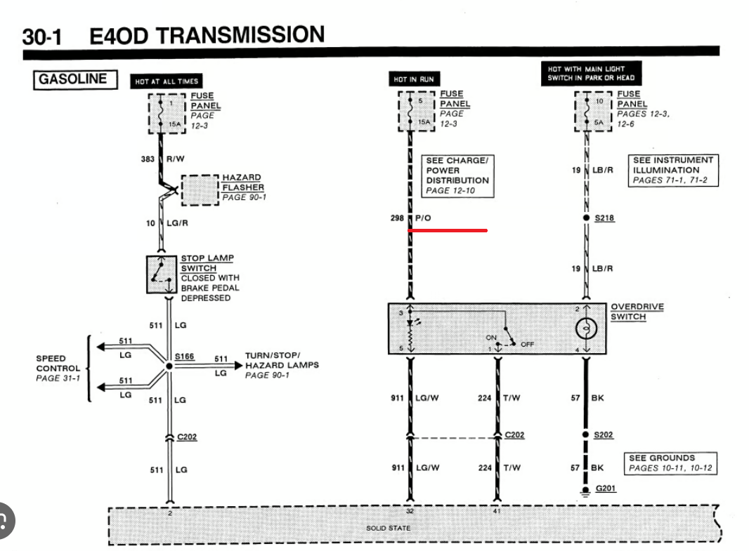

Originally Posted by mattt181
Is this switch a momentary switch or a true on-off switch? I am looking for a switch like this to use with an AOD Lentech valve body that needs a true on-off switch, but I suspect this switch is a momentary switch.
Is there a switch like this that is not a momentary switch? Or....is there a way to wire this up so it's no longer momentary but operates like a regular on-off? It has 4 or 5 wires. Thanks in advance.

Holy thread resurrection "batt man." You just joined today, have 1 post and posted here. Why? If you read what I wrote, you would see your answer is useless. It does not "plug right in" with a 91 switch as I was trying to use it in a different application.
Originally Posted by Mark Kovalsky
Do you think he waited 8 years for your answer? This thread has been dead since 2012.
Right!?!? I am still here and I gave up on figuring out the wiring on this switch, at least for the last 8 years...but it would be sweet to figure out how to make this switch work in my application. In the mean time(8 years), I just went with a simple on-off switch. I still have the Ford O/D delete momentary switch though.

Better late than never.
I needed this to access the Power-in-Run wire (P/O), it is easy to splice in at the connector. I use Power-in-Run to drive a relay for my Air Horn Compressor, the source also drives the HVAC fans.
