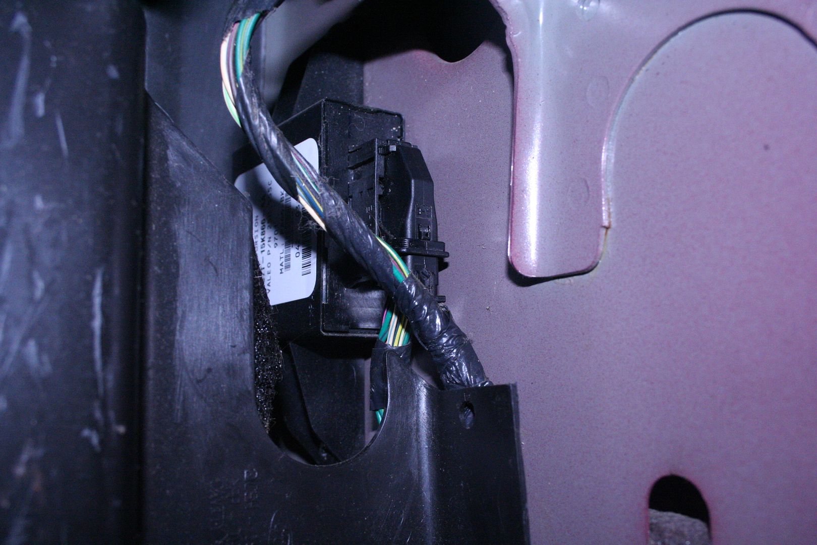

Here are some pictures of the Rear sensing Module location.
Jack
Module Location behind jack. Jack took in out.

I dont see anything there. Do you know if there is some intermediate harness that plugs in somewhere (where ever the dash wires end and then goes to the area behind the jack?

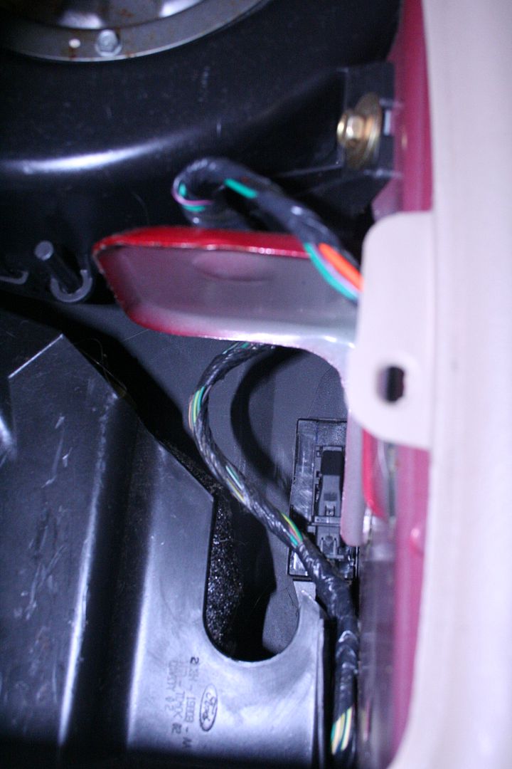

Pull out your passenger tail light and see if there is a big plug behind it.

So I pulled the taillight and no plug there.
I am at a loss where the dash wires run to. Any other ideas?

The plug is mounted inside the light hole on the body.

I really do not see any wires there, are you sure there is no other location they could go to?
