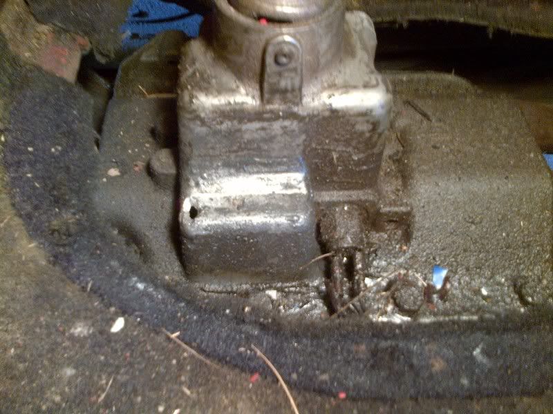

Could this hole have happened due to bad cab mounts, allowing the cab to settle on the top of the tranny and rub through?
What is the availability of the top tranny cover?
Would JB Weld take care of it or would the lube eventually leak through that too?
How do you remove the shifter? Nevermind...found the thread with instructions
Should the 2WD have a cover like this minus the 4WD shifter hole?
If I put carpet back down, what is the proper layering? I would think the tunnel cover with a seal would go down first and the carpeting over everything. This had the carpeting under the tunnel cover and with the tranny hole and leak, the carpet was soaking up the gear lube and whatever else could reach the edges.

Quoted a price for the tranny top cover of $75 from a local jerk and pull. Does that sound about right? Anything to look for or replace inside the top cover before installing?

I think I paid $50 for mine, and it came with the shifter. While your in there, there's some nylon inserts that are on the end of the shift forks, pretty easy to replace.
Just one thing to watch out for, they used two different top covers for those trannys, and they will interchange, but you have to switch out the shifter to match it.

What's the easiest way to tell the difference between the two top covers?
Nylon inserts slide off?

The height of them is different, on one style the very top is about 7/8 inch taller the the other, it's pretty obvious if you have them side by side.
The nylon inserts just pop right off, easy as that!

We still can't get the D@mn! shifter off of the top cover. On the NP435 if I take off the top cover, will the shifter come off with it. I have to replace the top cover anyway and thought I could get a better push on it with the top cover off.

Couldn't get the shifter off by myself so I removed the top cover to take with me to the salvage yard tomorrow.
Is the reverse fork supposed to have a nylon insert on the end of it?
With it being in neutral when I pulled the cover off, do I just line up the holes and drop it down or do I have to make sure something lines up?
