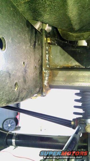

These are bolted to the frame, here are a couple of the mounting points
The center mount has an upward angle with the gusset on the bottom

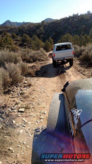

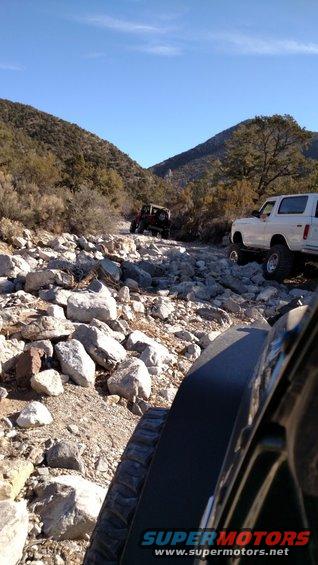

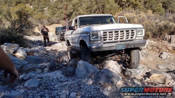

Ran a nice trail yesterday with Vegas Valley 4 Wheelers, primarily a Jeep club but a real good group of guys, only a few snobs lol
This trail is generally ran by guys with lockers and I must say it would have been much easier but we made it through!

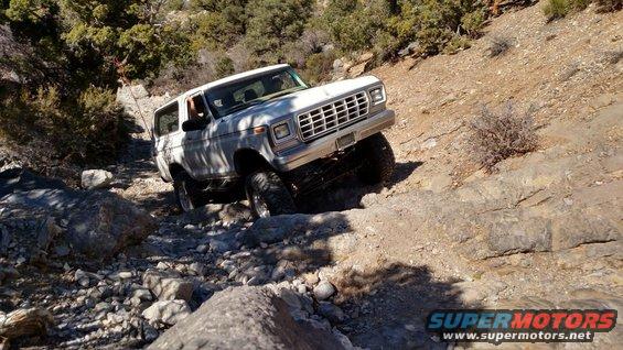

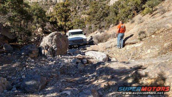

Got a bit stuck here, I slid down off the rock and pinned with 1 rock in front of the front axle and 1 behind the rear, a locker sure would have been nice here lol

That looks like fun! My 78 may see something like that in the future if I can find out where to go.

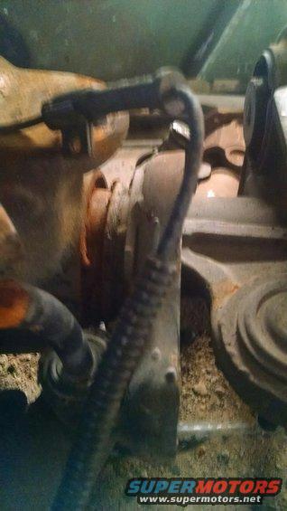

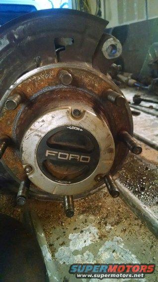

Started the tear down, just couldn't resist
The manual hubs are pretty cool, an assembled unit that bolts right to the unit bearing.
Got the driver side down to the housing, passenger side tomorrow, then start cutting off brackets.
