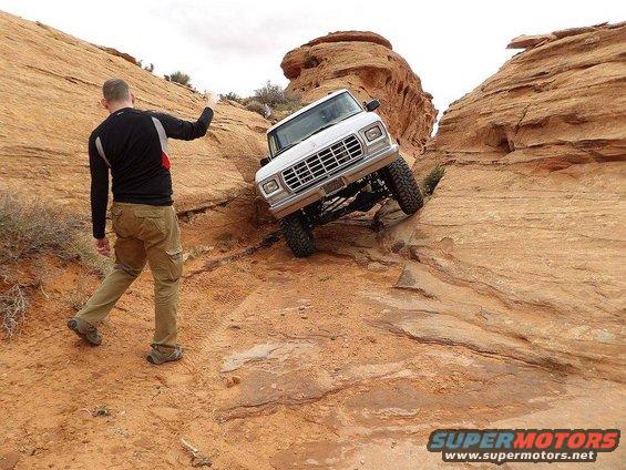

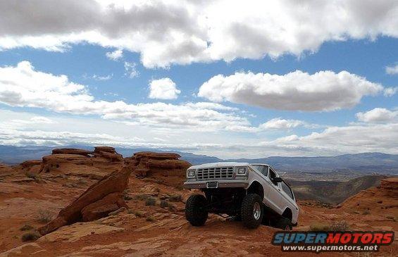

Wow, I haven't posted here for a bit lol
Been wheeling the hell out of the Bronco and having a blast!

Looks like some awesome fun!

Looks like a good time!

I thought you had lockers? the crawl in that last video would have been nothing. Actually pretty awesome how it can do so much WITHOUT lockers.
Old Mar 18, 2016 | 01:29 PM
  #683
Raleigh1's Avatar
Raleigh1
Joined: Jan 2012
Posts: 954
From: Viva Las Vegas
No lockers just yet, I have a locker for my new front axle that should go in next weekend though, that should be a game changer!
