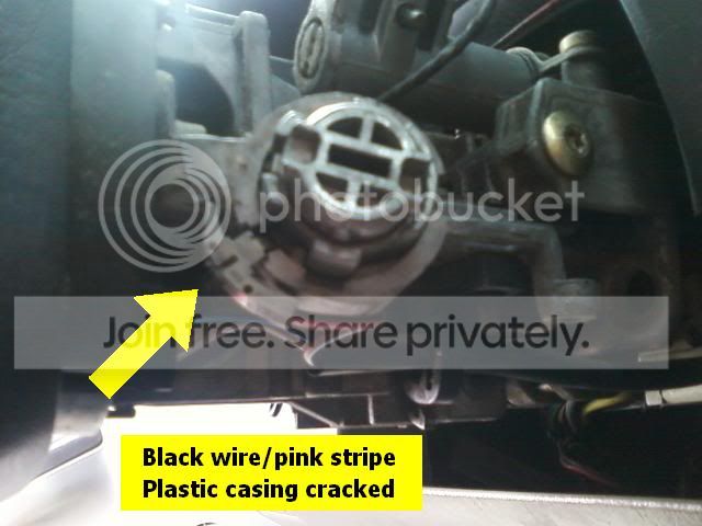

Multi-part question here. I'll start with the most important...
There is a gray plastic clip with an electrical tang that goes down beside the ignition tumbler. It has a black wire with a pink stripe coming off of it. It is cracked, and sometimes I have to wiggle it into a "sweet spot" to start the truck. Obviously, I need to fix/replace this, but to do so, I need to know what it is.
Pic for reference:

The black with pink strip is for the door chimes, I've had mine removed and taped to eliminate door chimes.

So, is it normal that when the gray plastic thing with the tang (that said wire goes into) is not in place, I lose power to the dash & radio, and lose the ability to start the truck?
Like I mentioned, the gray plastic thing is cracked on mine, so it tends to fall out or not be in the right spot, so I have to wiggle it sometimes to start the truck.
