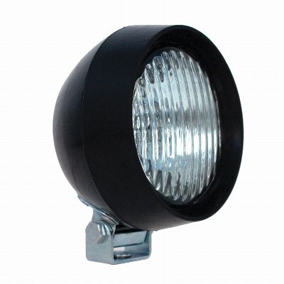

I considered a bunch of different lights. My concern was with such a long distance from the rear axle to the back of the bumper (HORRIBLE departure angle) that if I put something there it could get ripped off if the rear end bottoms out.
I decided to go simple and get the generic work lights from AutoZone/PepBoys/O'Reilly's/insert your favorite auto parts shop here.
They are rubber housings with sealed beams you can replace if they go out. If they get hit they can flex without breaking off. I drilled a small hole at the end of the bumper mount (outside of the vertical strut). Cheap and effective. Tied them in via a Carlin switch on the 650 dash panel, but you can wire them direct to the reverse lights with a relay, or do like I did on my Expedition and put in an couple of diodes and an on-off-on switch to choose constant on, off, and on with reverse.

AutoZone lists the Hella brand for $9.99 per.
Hella/4 3/4 in. 55 Watts 12 Volt rubber halogen work lamp (H15986001) | Auxiliary Lights | AutoZone.com
I think mine are not Hella brand...but the pricing was about the same. I got the off brand because I saw they had stock in replacement bulbs right there, but if Hella is what they carry and you like them, go for it.
Diodes to do the three-way switch were maybe 1 or 2 bucks. Wiring I had laying around. The three way switch was another 2 or 3 bucks.
The current layout includes the Carlin and F650 dash panel - thats a few hundred, so I'm sure you'll want just the 'basic' setup I had on my Expedition.
