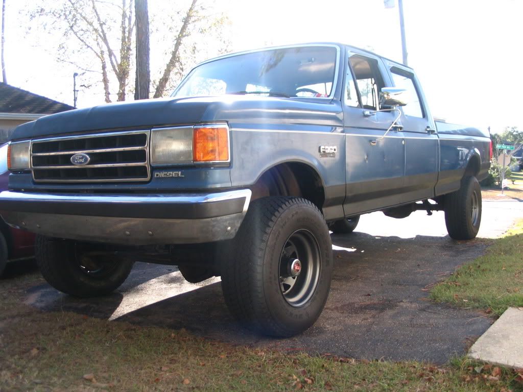

Ok im totally fed up with the e4od in my 90, its got electrical problems i cant hunt down, anyways all my previous ford have had manual transmissions in them, this one is going to be the next,so obvisously im better off trying to find a donor truck, should i try to find the borg warner t19 from a 6.9, or go with the zf5 5 speed, im running 3.55s in the rear, also if i find a complete donor truck thats four wheel drive how hard would it be to change that over too, or should i just leave it 2wd, im not too worried about having four wheel since my nissan titan is, but what ive seen with these old idi's and 4x4 they go thru any snow that mother nature can dump, i did find a swap on ebay, comes with the transmission, shifter, flywheel, clutch, slave cylinder, master cylinder, and fork, he was missing the crossmember, pedals and driveshaft, im curious too about the driveshaft due to my truck being 2wd if its necessary to swap that too
Its not that hard to swap it over. If you can only find a 2wd ZF5 then you can installed a divorced transfer case.
I have some experience with this 2wd to 4x4 conversion. Donor truck makes is nice.
I still havent installed the ZF5 , I have been super busy , but it s coming, the E4OD is coming otu as soon as I get time.

thats a nice conversion there going from 2wd to 4x4
I'll disagree!!!
The transmission side of things is a piece of cake. Either get a 4x4 tranny (easy) or do the divorced transfer case where you have to fab up a crossmember, then do some driveshaft work.
However!! Putting a 4wd front axle in a 2wd truck is not easy or fun. The 2wd has a coil spring suspension. The 4x4 is a leaf spring suspension. NONE OF THESE PARTS ARE BOLT ON SWAPS! You can take most of the parts off the 4x4 truck if you have a donor, but you need to carefully measure and drill holes to put them on a 2wd truck. Not to mention, the front frame horns are different so you CAN"T bolt on the front shackle mount for the springs without some modification to the frame.
I did it because I found a 2wd truck for cheap and figured it would be a good project. I spent a lot of money and time converting and it was not worth it. I and most other people, would do better buying a 4x4 to start with.
Chris 72, if you did the swap and you're happy with it, good for you. I'm mostly happy with mine. If I could find the time to redo my front springs the right way (or at least swap on some better springs) I'd be a lot happier. But mine is my daily driver, and that really throws a wrench in things as I don't currently have a backup vehicle.
