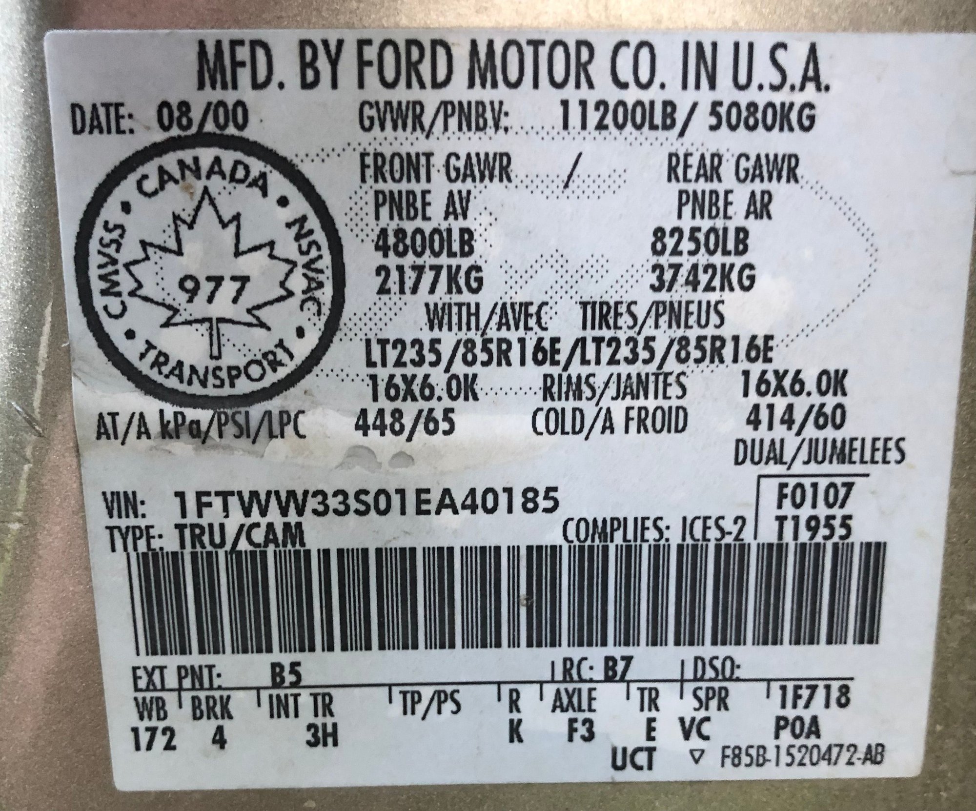

2001 F-350 Super Duty 4X4 DRW 6.8L V-10 replacement upgrade
My 6.8 put a rod through the oil pan in the middle of a trip and I had a local shop put an ATK/Vege crate in. It started knocking at 2k km and and is showing ferrous in the oil filter so they have agreed to replace it.
It doesn't quite haul my 8000lb trailer up the hill as I would like, so I'm thinking of upgrading to a full dress engine and I would like to know if anyone has put a later build V-10 into a 2001. Specifically, I would like to put the 5C3E block 3 valve version that has 50 more hp. and give it a boost with headers.
https://www.enginebuildermag.com/201...rd-triton-v10/
I'm pretty much stuck with ATK for a warranty replacement.
1) Will it bolt up to the tranny?
2) Is it compatible with the existing peripherals like ECM, wiring harness, hoses, intake, etc.
Many thanks for any insights!

You will have a very hard time adapting a 3V V10 into a 2V V10 truck without spending way more than it is worth.
