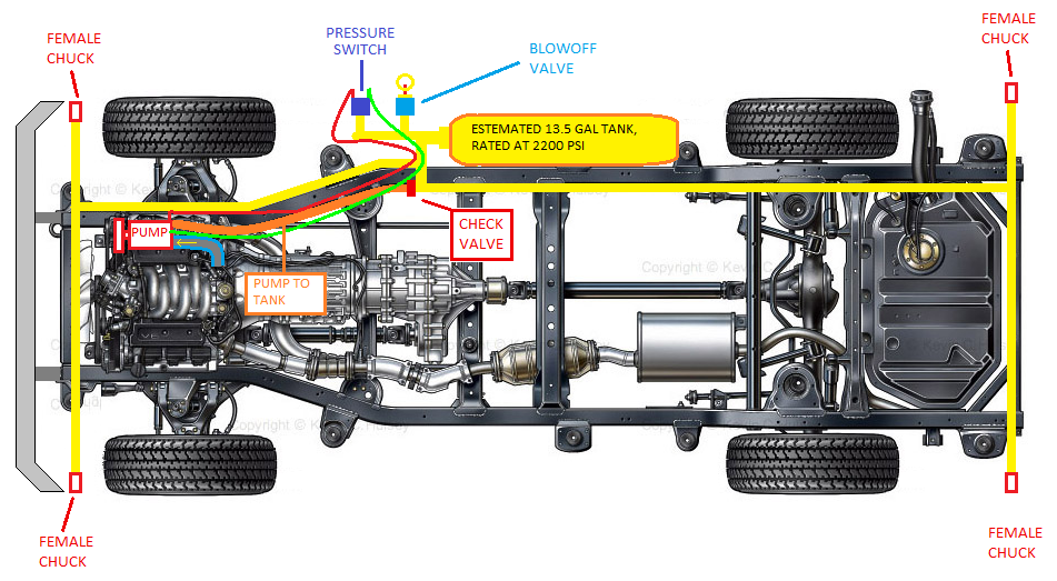

update on my plans....
I have access to a few large, thick walled cylindrical tanks. They're rated at around 2,ooo psi. problem is, it only has one port, so I figured, if I were to run it on the end of a system, and make a manifold to go before the tank, would this work? I figure around 200 psi. check valve, blow off valve, regulators, etc. this is all with a York, Mopar RT2, or Sanden compressor, whatever I can find at the salvage yard.

I've seen tow trucks with on-board air tools, but I never thought much about how they worked. But that is a cool diagram!

when I did mine I used 6 ~1/2 gallon oxygen tanks I had a manifold come off the York compressor and it split to the tanks outlet and pressure let off
compressor----------->pressure relief
V V
outlet tanks
I used 1-1/4 aluminum round stock and ford power steering lines from the 80s for most of it
Sure it will work. All the tank is, is an accumulator. With properly sized lines, it will work fine.
Old Oct 2, 2016 | 02:59 PM
shameless's Avatar
shameless
Joined: Feb 2009
Posts: 555
so, with 300 psi rated parts, you don't see any reason why this might not work, or any reason why it might be dangerous? The 1/2 gallon tanks might be a good idea too, how many gallons would you guys recommend, I only said 13.5 gal because I have access to it. but I may be able to talk the airgas guy into letting me have a few old tanks that cant be used for 2K psi anymore.
