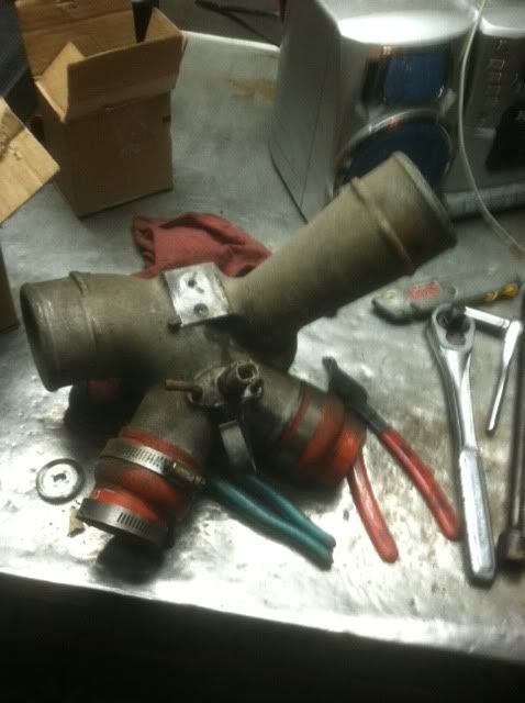

Comparison between early 99 and late 99. I hope this helps you

Arrow
Originally Posted by bad12jr
It's coil of wire that goes in the front of the intake y on the cold side of the y pipe. But hardly ever operates and is a huge restriction. What the SD guys call AIH delete.
And if you want to supply the hot air let me get a video camera.
I suppose that its in the last pic I posted above, and its the nut with a device that its on the cold side of the spyder, right?
Old Dec 12, 2011 | 11:08 AM
fordpride's Avatar
fordpride
Joined: Dec 2009
Posts: 15,505
Likes: 18
From: Livoina,La
Correct alot of the SD guys plug it
