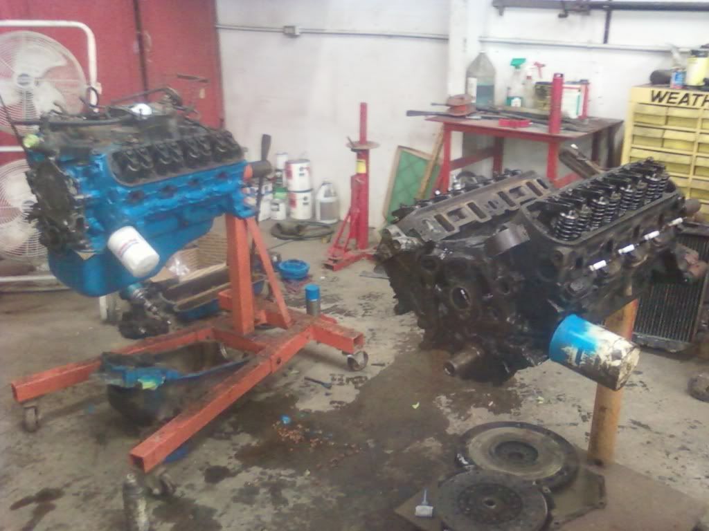

Finally got the pictures!

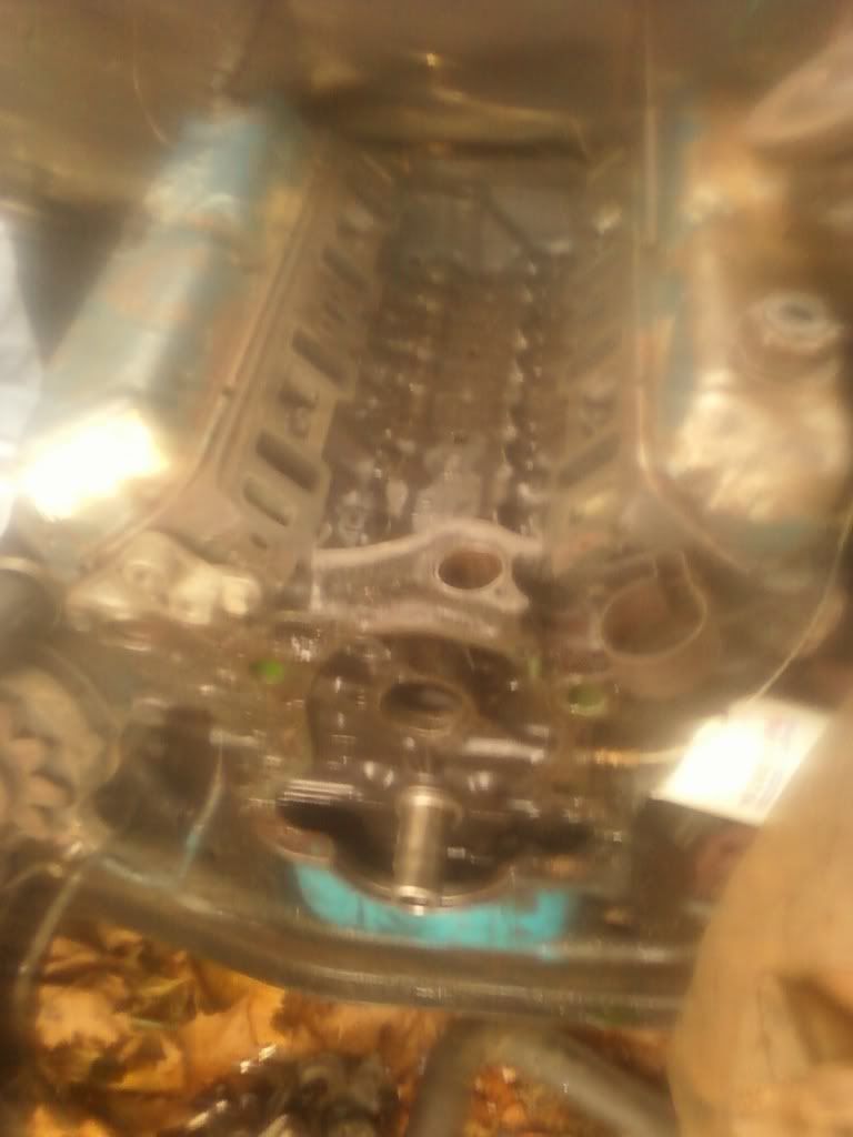

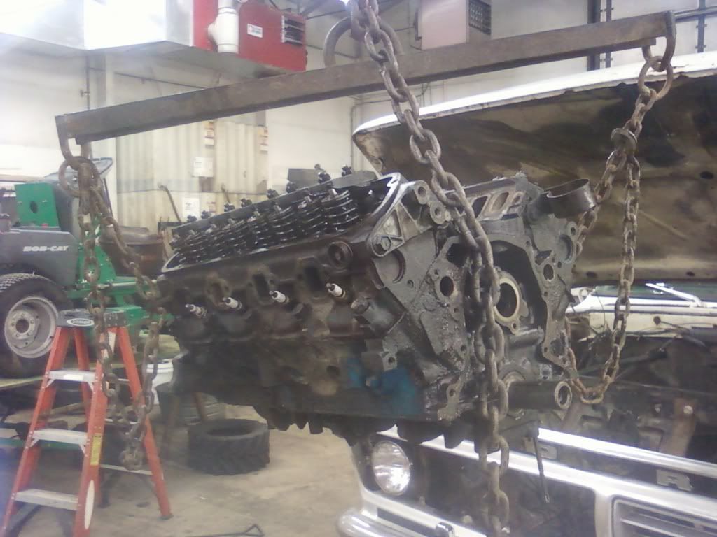

Started tearing down the engine at my barn.

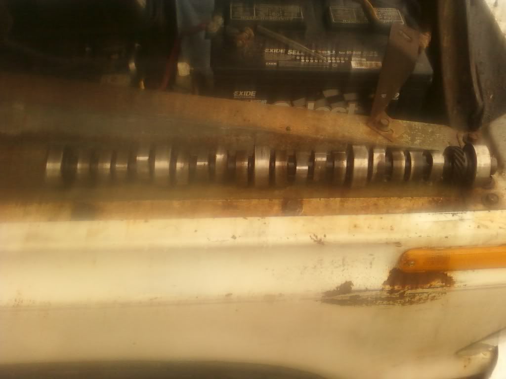

This is what a cam is supposed to look like

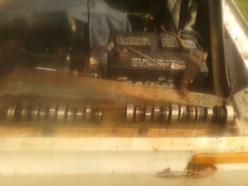

This is what mine looks like!
It's finally out!

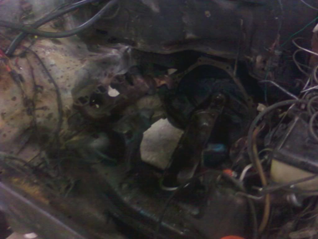

She looks so empty without a engine

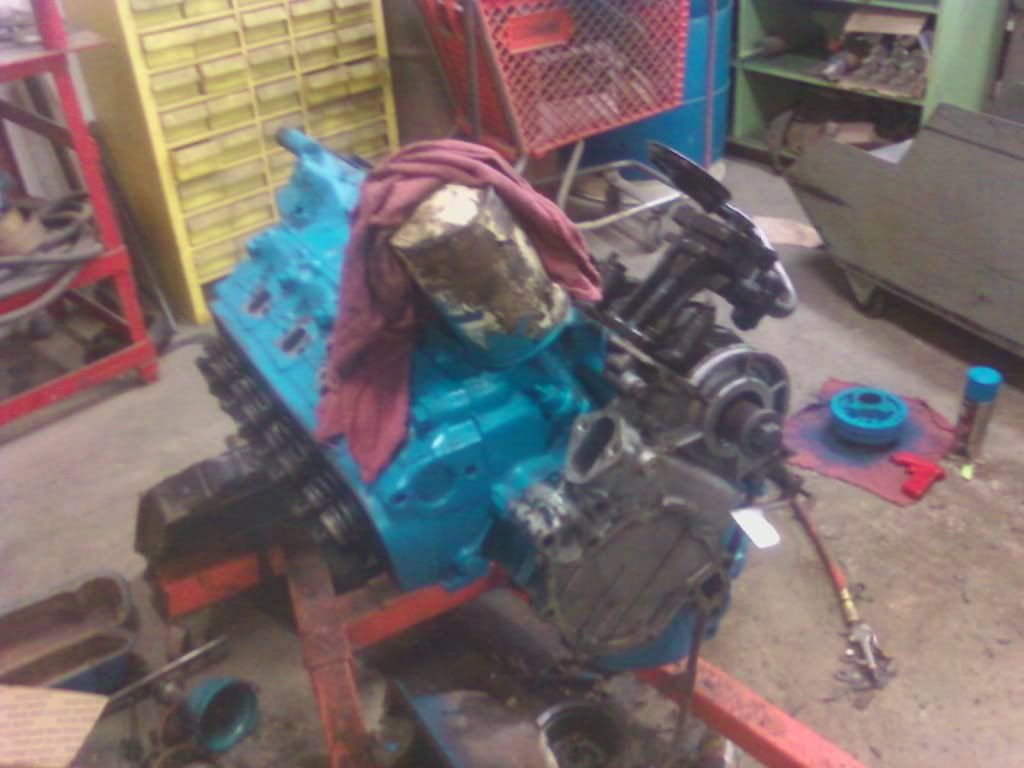

Workin' on the HIPO

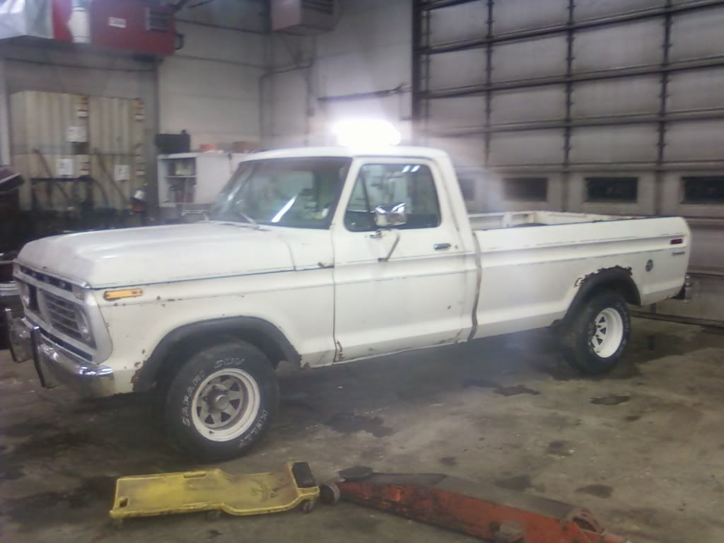

I think this is the first time my truck has even been inside!

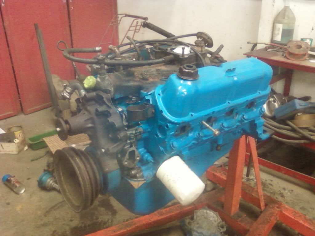

Old and new together

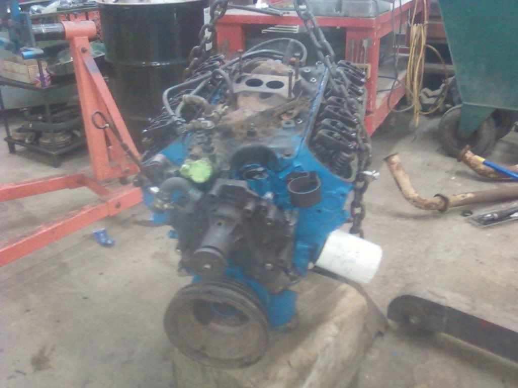

Lookin' pretty!

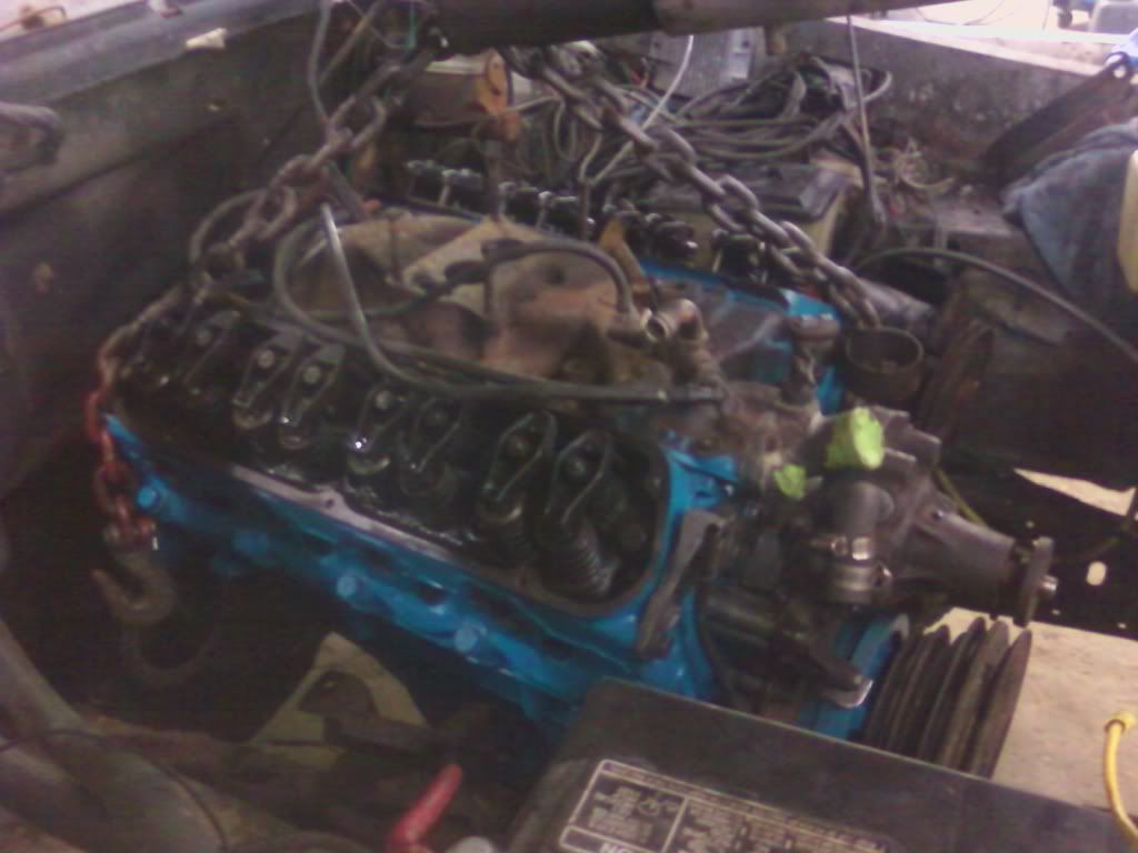

Ready to go in!!!!!
Gettin' there!
Success!
That`ll buff right out

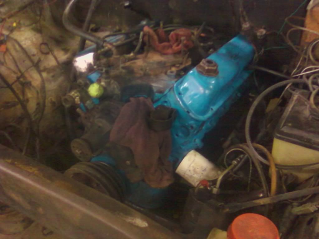

Nice and big update! So I was having trouble getting the transmission to hook to the block. That was the only thing keeping me from being able to finsh everything. We I realized that my drivers side motor mount slid down the slot on the perch. Once I realized that I smacked my head that it was something that simple!
So out came the engine hoist to lift up the drivers side of the block. Finally I got it fixed and after spending a while fiddle with the trans I got it to finally go in! So II then bolted the start up and finally got to start putting stuff on to get it running! On went the carb. Right now I'm temporarly using the stock 2bbl manifold from the 302 and my Holley 350 cfm 2bbl till I can get a 4 bbl intake I already have a edelbrock 650 performer.
Now came the truck part once I got the carb on and the wiring done I had to put the mess of vaccuum lines on. Luckily I had taken a picture on my phone before I took everything apart so I missed the bullet on that one. I had gotten everything on and the truck ready to go to start which I had been waiiting for like a little kid on christmas morning waiting to open presents.
So I filled the float bowl with fuel and for a temperary thing I just got a long rubber line that hooked to the fuel pump to a can of gas. By this time I am bouncing all over the place in excitement to start this bad boy. I hop the truck turn the key then.............................................. . absolutly nothing lol.
The battery was junk. Grrrrrr. So I pull my ram in the shop and take my optima red top out. I get in again even more excited just because I know It'll start now! I turn the key and all I hear is the truck turning over. No fire gahhhhh! I get out and check for fuel. I got it. Check for spark and I don't got it, so I start to troubleshoot and it took my two days but I found out what it was.
The 3 wire connector on the distributor to the wiring harness looked good but I found that the ground wire on the distrbutors side of the connecter came out of the connecter so I shoved it in and I got a big blue spark. I'm so happy at this moment! Because it should fire now!
Try to start it and nothing. I kept getting popping through the carb. Duh! I'm a 180 out. I get that fixed and VVVVVVVAAAAAAARRRRRRRRROOOOOOOOOOOMMMMMMMMMMM!!!!! I seriously about peed my pants from the adrenaline rush. I didn't want to hear that sound I needed to hear that sound.
After getting it timed to 6 degrees BTC and getting the AFR adjusted the best I can before I take it out I threw the front acceriories on, the ratator in and finshed buttoning up the engine compartment. I had decided to call it quits for the night and end it on a good note.
