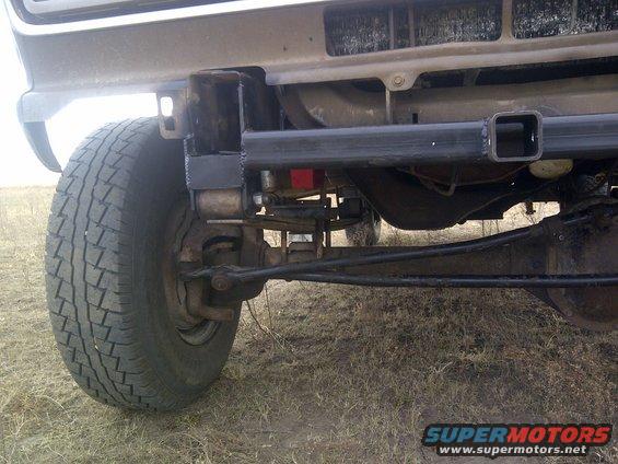

Glad to see you working on the van. I figured you were raped and pillaged by hobos and left for dead.
Brackets look good. Are those shock mounts factory for a van? They appear taller than 150 or 250 mounts.

Nope,no hobos around here.. Lol
The shock mounts are off the 92 F350 the axles and springs came from.
The only parts I have had to buy so far is some steel, spring bushings, one u bolt and front brake lines. Every thing else I had in the parts shed. I am in the process of swapping to a flatter pitman arm so the drag link clears the springs. But it looks like the 92 F350 steering will work just fine.
The trans I'm using is a C6 out of a 78 F150. The t case is out of the same pickup the springs n axles are from..
I'm also thinking of slapping my 203 rang box in there for ****s n giggles.

by them pikturs it sure looks to me like you are missing a wedge between the passenger spring and axle perch.

Both sides are the same with the exception of some black paint........
Edit: There r no blocks under the springs, zero rates to move axle forward....

ok, it looks like there is a gap between the spring and axle.

O, the one edge of the zero rate has a curved edge

Tom the piece your calling a gap i believe is a silver colored piece there... atleast where i think your looking

now that you said with black paint added i realized you had a silver painted wedge there. but if you don't look at it closely it looks like a gap between the spring and axle.

is the zero rate in the 1" or 1.5" position? Mine came in the other day. Looks like a pretty slick deal.

1.5 position. They seem to work pritty good
