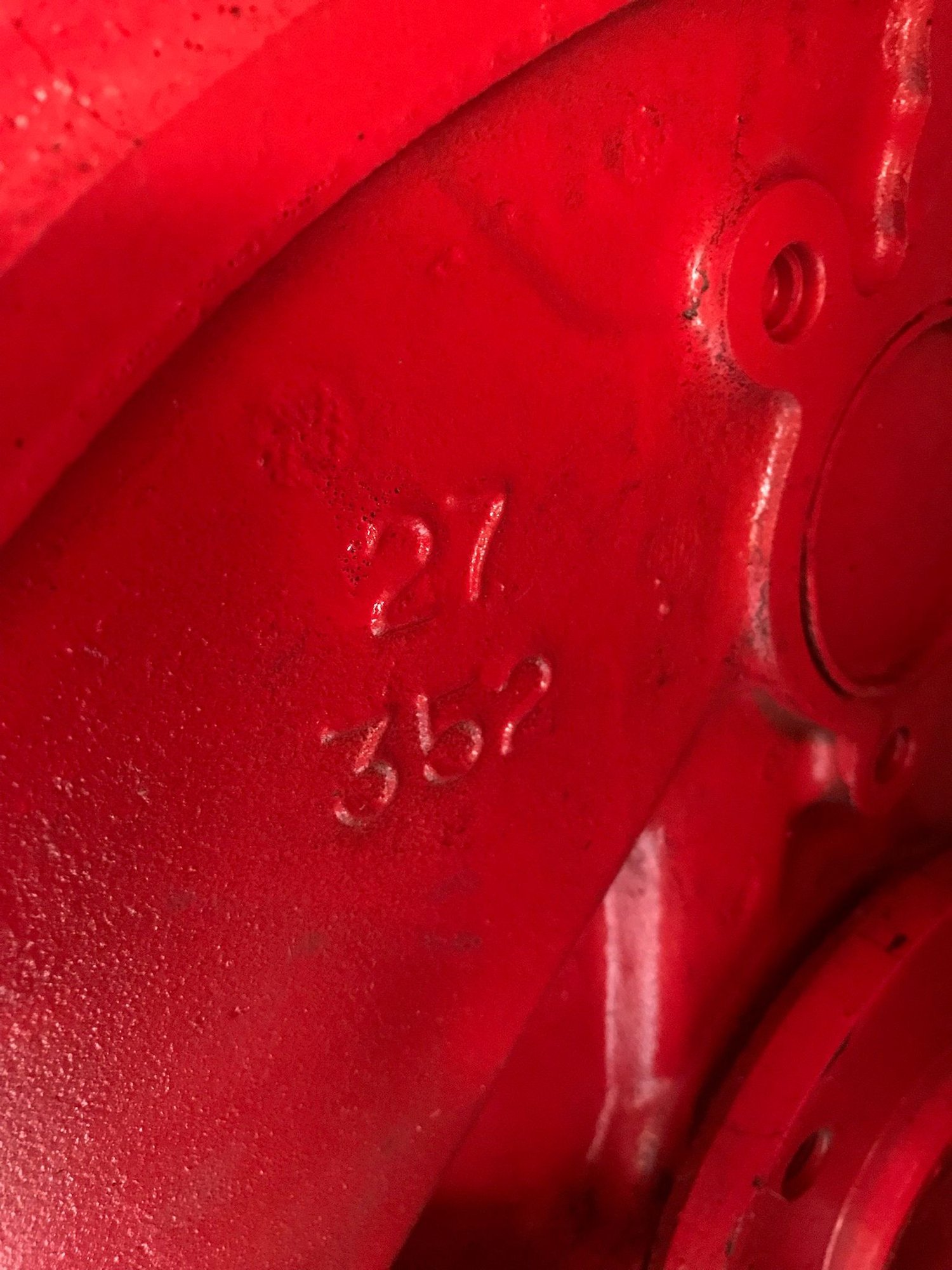

block stamped 352?
looking at the front of the engine on the right side the block right of the water pump, is stamped with a 61 or it s a 67 and right below it is stamped a 352.. does that mean its a 352?

Many FE motors of all displacements have "352" cast in the front. Measuring the bore and stroke is the only reliable way to determine displacement on almost all motors these days.

I measured the stroke on my FE by using a wooden dowel. Remove the #1 and #4 spark plugs, rotate the engine to TDC, and measure the difference from the top of the cylinder to the plug hole. I thought I had a 352, but after the measurement found that I have a 390. There is a casting number on the side of the block which can tell you the yr of manufacture but still give you multiple options on engine size. It's just like 85 says, measuring bore and stroke is the only reliable way. Good luck.

Help me please I need to know what this is and if it will fit in my 07 p71?

"07 p71". OK, what is that? A 2007 vehicle?
As to the engine pictures, is that a "C3AE" in the first picture?
Please clarify.
P71 as in Crown Vic?

Sure, you can make a 60's FE physically fit in an '07 Crown Vic. I put a 7.3L Powerstroke in mine. I also put a 4.6L in a '74 F250 where an FE used to be.....and the 4.6 takes up way more real estate under the hood.
It's the "getting the power to the wheels" that is going to take the most thought although there are joints making adapters to stuff a modern transmission to an old FE.
My guess is either a mis-posted bunch of pictures, posted in the wrong forum, or not really sure what he's looking at.
