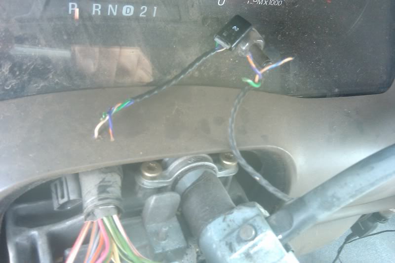

Finally made time to fix this pesky little problem. I will echo the scores of X and Super Duty owners who have said repeatedly over the years to FIX this BEFORE the wires get chaffed enough to short... I didn't listen even though I knew about this when I bought the X and waited for it to fail .
The problem:
The wires for OD switch travel thru the shift lever and after exiting they cross over the top of the column and plug into the wiring harness. Since these wires need to allow the shifter to move as well as the steering wheel to tilt - the wires also move when these things are moved. As the wires move back and forth this 1/4", they eventually wear thru the insulation and expose the wires. Initially, my OD lite would come on for no reason and eventually I was blowing fuses when shifting or using OD switch. As far as I can tell, THIS WILL HAPPEN TO EVERY ONE OF THESE TRUCKS - eventually. Seriously, its an EASY fix if ya do it NOW - it takes 20min, a phillips screwdriver and some tape!

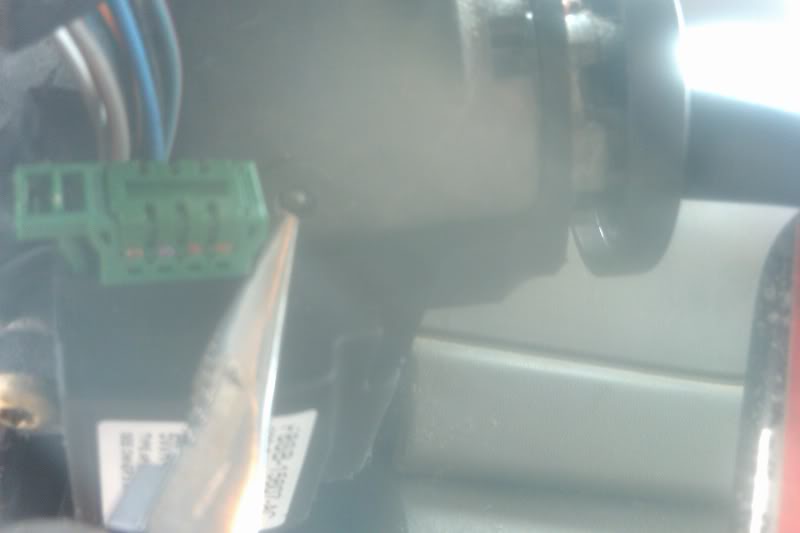

First, remove the (3) screws that hold the plastic trim around shifter. Unscrew the tilt steering lever and remove lower plastic piece. With ignition in 'on' position, press the little shiny ball on the bottom of key cylinder and remove the cylinder.
Attachment 202621
Now you can slip the upper plastic over the shift lever and get it out of the way.
Attachment 202622

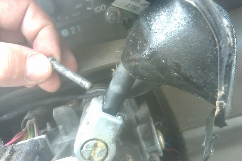

Since I'm a dum redneck and waited until I had a problem, mine was worn completely thru one of the wires. I was trying to strip it back and repair it in place and pulled the other 2 wires apart where they were crimped at the hold-down thingy attached to this black trim piece.
Attachment 202623
If I was smarter, I would have just unplugged the wire from harness and removed the pin in my hand and slipped the shifter lever, wire and black thing off so I could take the whole thing out where I could get to it... Don't try to slide that black piece off the shifter, its too big and will tear. This one was already torn and fugly - anyone got a part # for it?? I'd like to replace this one.
