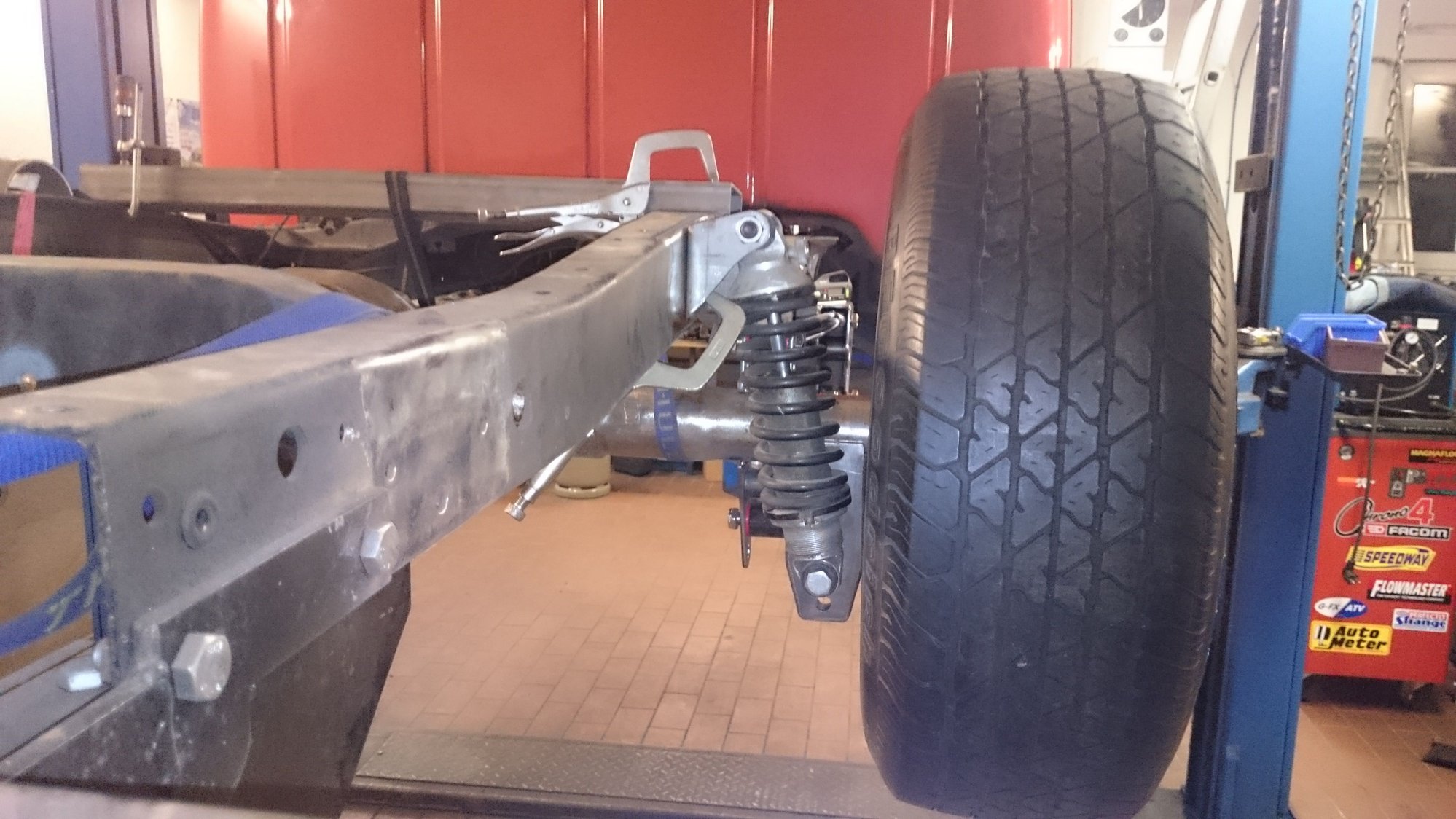

Originally Posted by Outlaw56
Ingo, are those the standard shocks that come with the No Limit Kit? Are they by chance Motorsports QA!? Any chance you could post a picture of your top shock brackets?
these coilovers are only for mockup. No Limit i mean provides ride tech, but ordered my kit without coilovers, because i want to use another brand and i want to figure out the length i need first.
upper shockmount. This is one more reason why i decided to go with the No Limit. This upper coilover mount is way stronger and the more outside the coilovers are the better they work

...yes i did a little c-notch too, it gives me room for the case i want the truck lower
maybe i really better start my own build thread!?

Well I think that answers my question, actually two of them. I think I got into the wrong box of parts in storage. I definitely have QA1 12-200s, not Ride Tech. I think the QA1's might be from my Heidt Wide Ride front end kit for another truck. If those are No Limit upper shock brackets, the ones I have are way different also. Again, must be from my IFS Wide Ride kit. Nice job on the C Sections.
