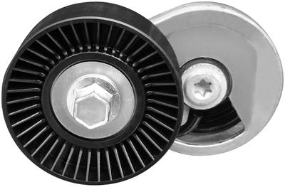

One more thing that has me iffy about running out and spending $75 on a tensioner. When I put a wrench on the bolt and tried to push down to tighten while the motor was running, I got absolutely no change in sound. However, it doesn't take much force by hand to push the tensioner down after I shut my motor off.

Here is a list of pulleys for a lot less than the $75 you mention;
Advance Auto Parts: Search Results for tension pulley
The complete assembly is currently $45
Dayco 200-89236 - Dayco No Slack Automatic Belt Tensioners - Overview - SummitRacing.com
Buy Dayco No Slack Automatic Belt Tensioner, Light Duty 89236 at Advance Auto Parts

also, a bit more testing, when I tighten the tensioner by hand with a wrench.. like if I push it down when the motor is off, when I restart it stays at that point and doesn't freely move back if that makes any sense? I know it use to move more freely than it does now.
In other words, if I let the tensioner rest by itself it moves to about the top of the "Range" brackets, if I push it down it moves closer to the middle and stays there without bouncing back up. I don't think a tensioner is suppose to do that. It will stay at that point while the motor is running.
