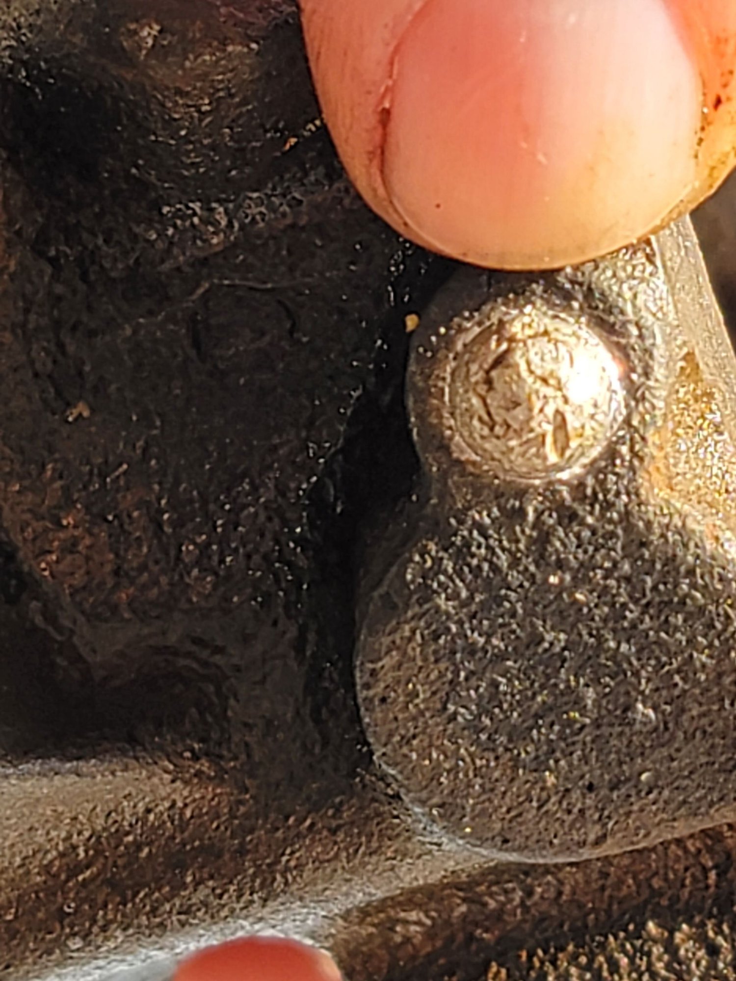

Old Jan 29, 2023 | 08:05 PM
  #2445
speedyweasel's Avatar
speedyweasel
Joined: May 2011
Posts: 435
🎶 You say you wanna resurrection well ya know... 🎶
Choke detent ball
After fighting to get Betsy to start and, you know, moving her 900 miles north to her new home in Idaho... I decided to rebuild her carburetor. Evidently that was a wise choice since the ethanol in Californistan left deposits throughout.
The carb has been disassembled, cleaned, and I'm beginning to reassemble it. But I've hit a snag. The choke detent ball has decided to become a permanent fixture here with zero intention of ever leaving. It looks brazed in place.
Am I correct in my opinion that it's supposed to be spring-loaded and have a small of travel? Need help on this one. Sure looks permanent, but I watched a grainy video from Mike's Carburetor Parts on YouTube and his was a moving detent ball.
Thoughts? I'll post more pics later on. I've taken quite a few. Carb is a 1949 7HT model, for what that's worth.
Thanks!
