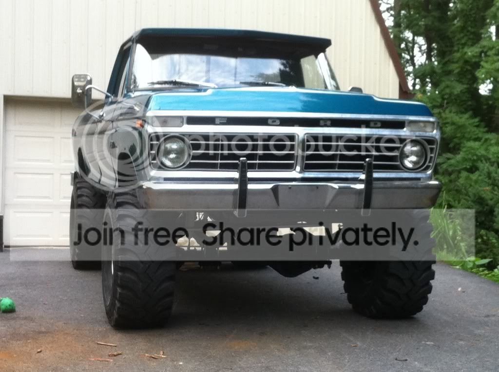

I was wondering what everyones preference is single or dual. I switched to the HP D60 from a 79 F350 which had a single on that was junk so I took it off. Since then everthing has been serviced or replaced with new. Saturday was its maiden voyage with the new setup. I ran it all weekend with the hummer tires without issue but yesterday I put the 40's on and it didnt like that at all. About 40mph it got the death wobble. Once the tires got some heat in them it wasnt as noticeable but still did it on a bumpy road. Right now I have nothing on for a stabilizer. The closed knuckle 44 was what it was with power assist but it never pulled one of those tricks. I need a stablizer ASAP.

It may not drive good but at least it looks cool with the wider axle in the front.
