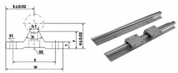

They use them on cnc machines, called linear bearings 2pcs SBR16-750mm Linear Bearing Rails + 4pcs SBR16UU | eBay
Any idea where I can find out how much weight they can hold?

There's usually specs if you look. Bigger diameter track more weight. You probably want something at least 1".
