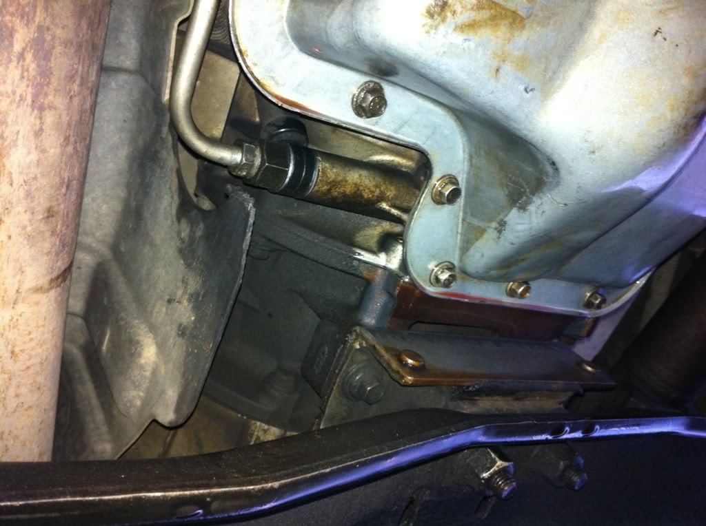

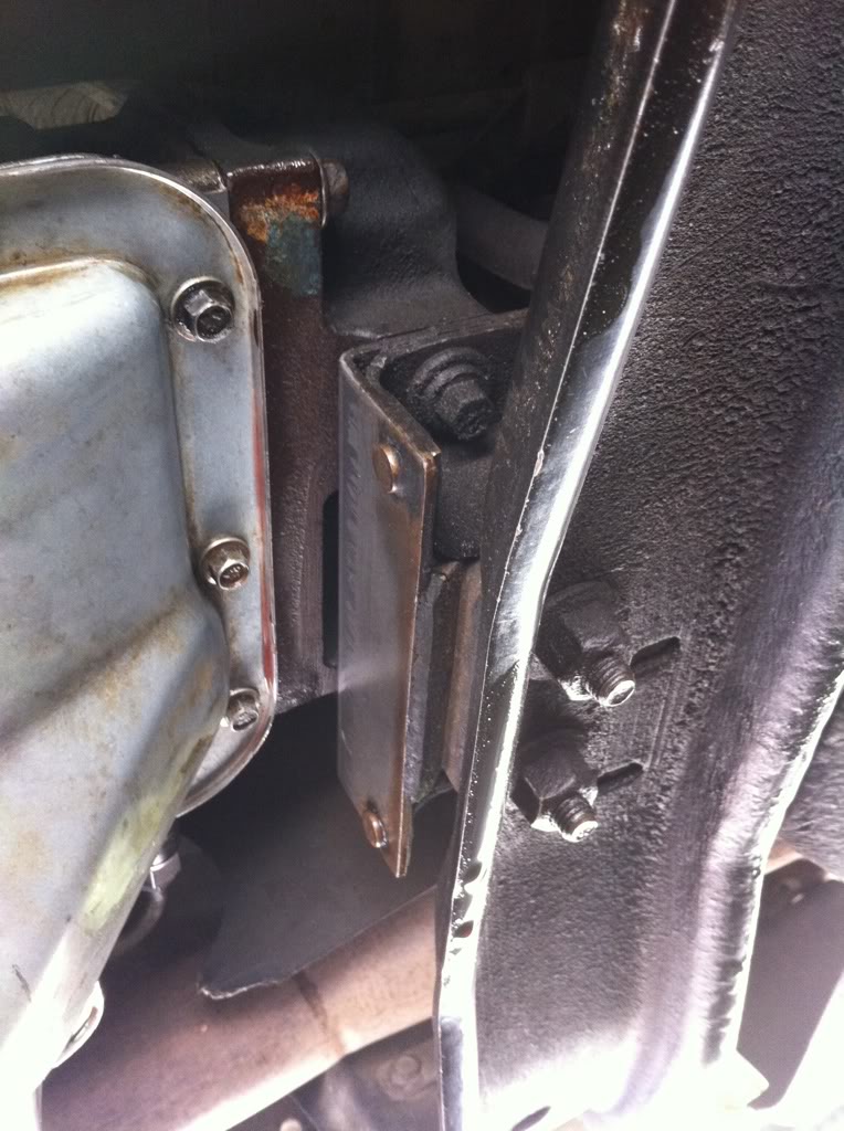

Originally Posted by nitro3421
I replaced the pan gasket and it's still leaking! No towing at all since this new gasket. I'm stumped, any ideas?? Here are some more pictures if it triggers a thought for anyone:
Attachment 202732
Attachment 202733
Attachment 202734
I know the discussion was old but did you ever found a fix for it. Mine has the same leak as your and I changed the filter and gasket but it didn't fix
