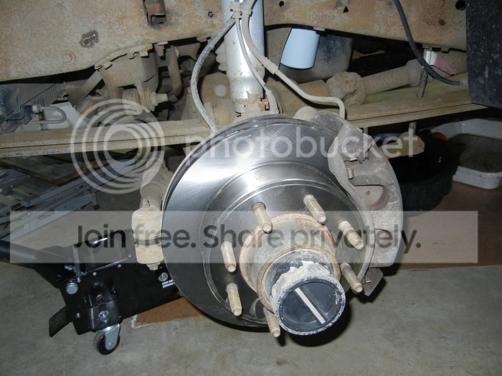

Next on the list was to get rid of the pulsing brakes. Thought I'd start with the fronts (assuming this is where the warped rotors are).
As soon as you take the wheels off you can see that the front rotors are warped (I'll show pics how, after)
Simple changeout. I don't know why I didn't buy pads at the same time, but mine were almost worn to the metal. Replaced them 1000km after the rotors.

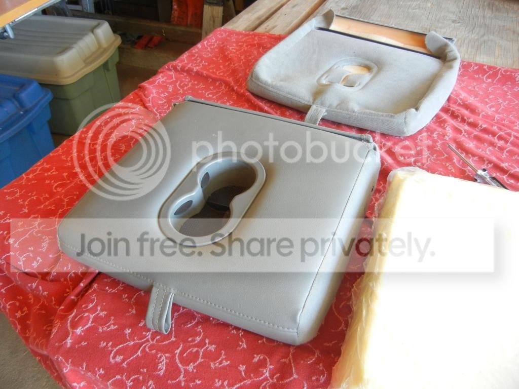

Picked up some gray leather 2nd and 3rd row seats to replace my cloth ones. What I didn't realize was that the 2nd row pull-out arm rest didn't have cup holders in it!!
So here I took the two arm rests out (the old one and new one) and removed their covers. The covers are the same minus the hole cut for the cupholders and the foam pads are the same minus the hole cut as well.
Cut a similar hole in the leather cover (just like the one in the cloth cover)
Installed the leather cover over the old cloth seat foam pad. Perfect!

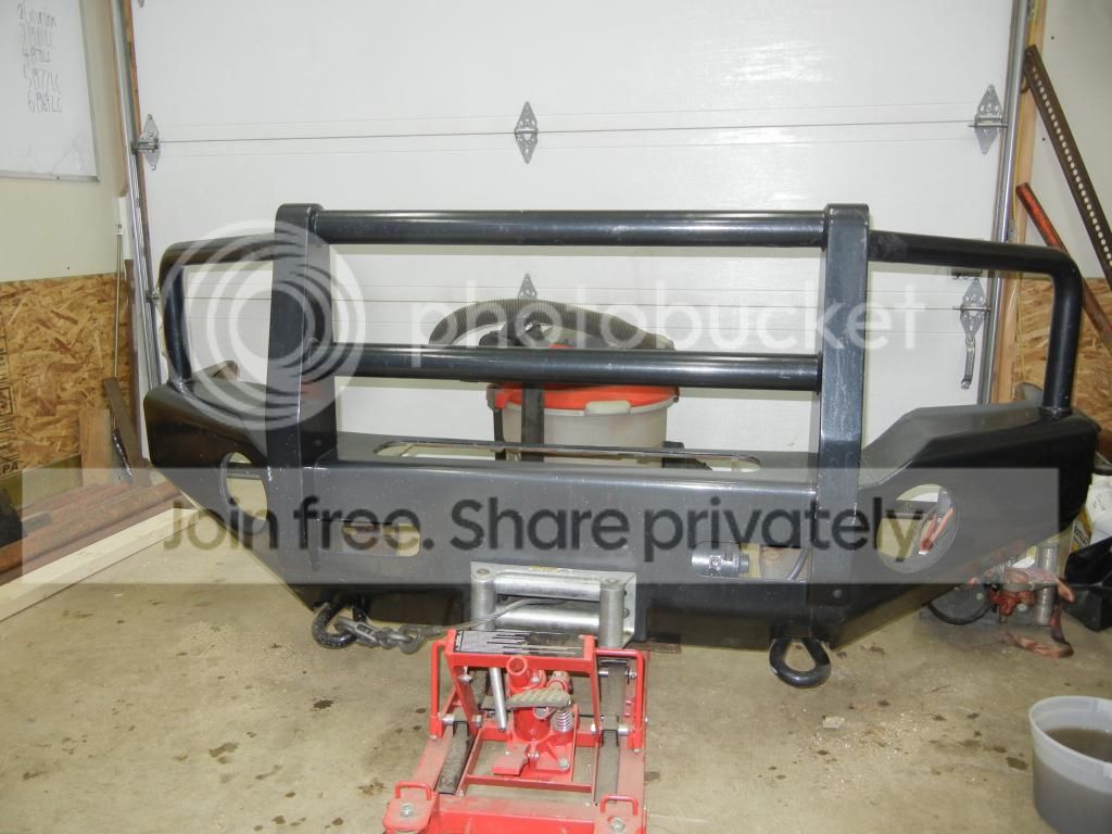

1 - Have the 3rd row seat back stripped down for installing headrests
2 - Picked up a used Buckstop (with winch and lights) to clean up and install
