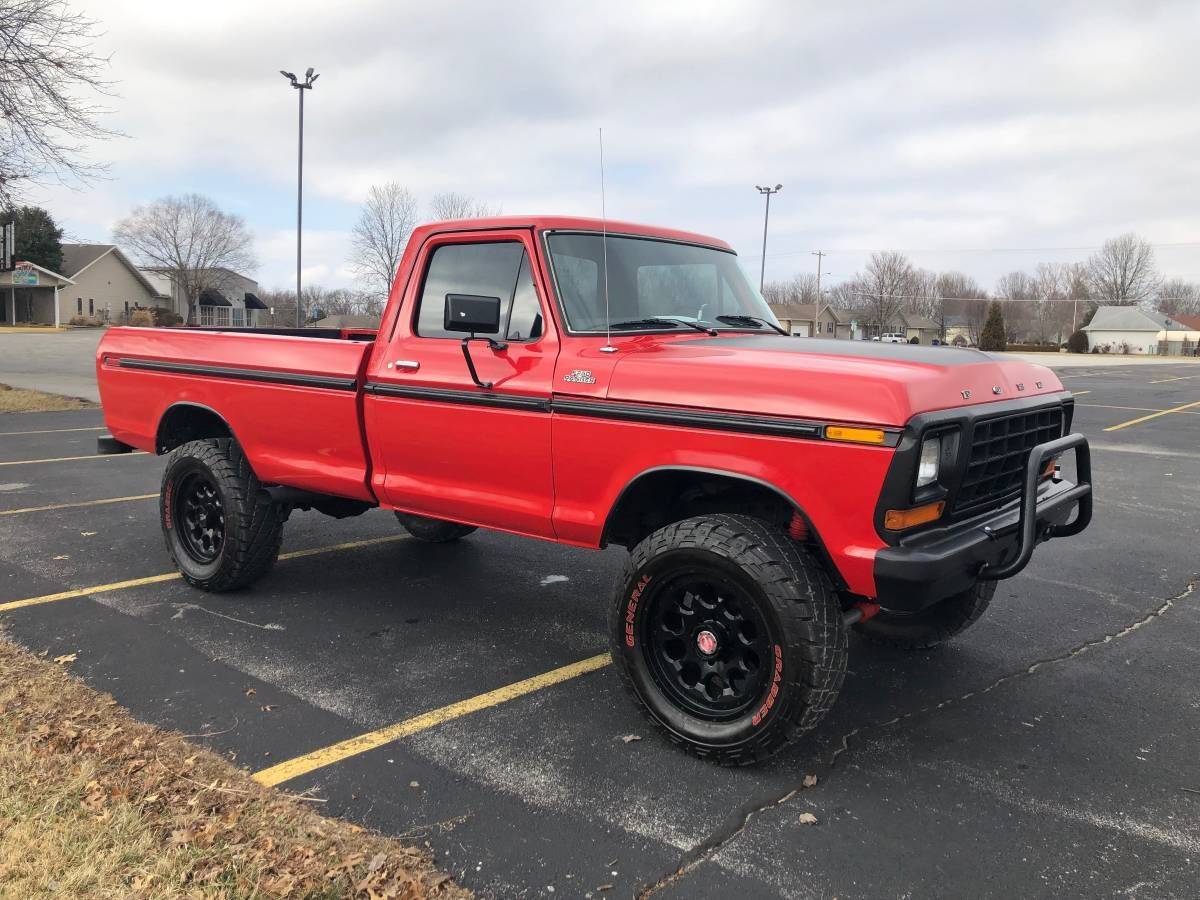

Just came across this post. Has anyone spray painted the trim and then applied a spray clearcoat to protect it?
Old May 7, 2020 | 07:53 PM
77&79F250's Avatar
77&79F250
Moderator & parts slinger
Posts: 49,797
Likes: 5,603
You mean like this? I am sure it will work if you prep the surface properly.
