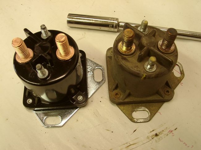

took a picture of the 110 this am.
see there is an 'I' and 'S' on it.
i haven't looked at the original on my truck,
but take it that these markings should be there also?
thanks for your patience
iowa
Old Apr 21, 2011 | 07:17 AM
cj45lc's Avatar
cj45lc
Joined: Feb 2010
Posts: 2,298
Likes: 94
From: Delta, CO
The one on the truck may or may not be marked the same. Just put your wires on the terminals just like they are on the truck now, if there are two wires on one of the lugs just make sure you keep them the same as mentioned above.
Old Apr 21, 2011 | 09:01 AM
danskool's Avatar
danskool
Go Bills !
Joined: Jan 2008
Posts: 2,778
Likes: 65
From: Buffalo, NY
Yup. Just ignore the markings. The two small screw lugs energize the coil which push the contacts shut. The big terminals are the big contacts and direction don't matter with them either.
Easy on the nuts when tightening those wires down or you will be running to Napa again. Use nut drivers if you have them and just snug them up, Dont use the 1/2" drive ratchet
