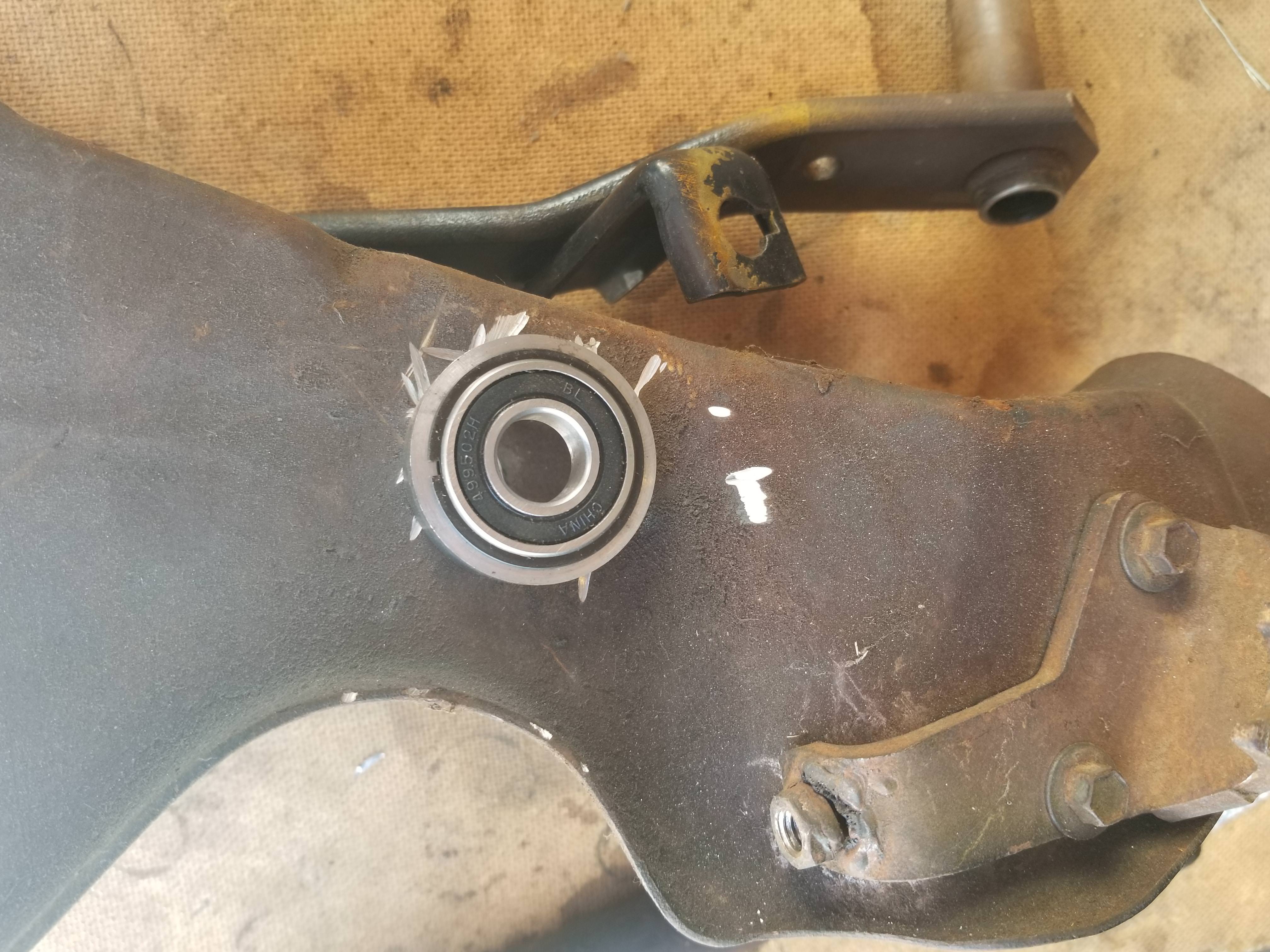

That spring is a bear. To reinstall it (didn't remove it since got the unit in the j/yard) I clamped it in a vise and zip tied it together to hold it compressed. Once in place, I snipped the z/ties.
An alternative to the plastic bushings:
Attachment 278412
Attachment 278413
https://mustangsteve.com/product/Bal...dal-Shaft-Kit/
