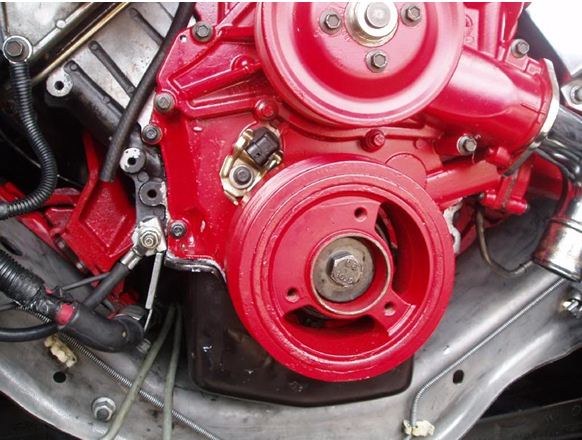

Welcome to FTE .. A cheap test would be a CPS ( cam position sensor ) get it from ford or international...Its about the only thing that isn't red next to the balancer Name:  CPS ROJO.JPG

I'm betting it's the CPS. When it dies, does it sputter out or is it as if you turned the key off?
Edit: CPS is Camshaft Position Sensor. It senses the position of the camshaft.

As the cam turns , the CPS reads the tone ring inside the motor & tells the injectors when to fire ...(basically )Name:  Cutaway CPS.jpg
Some one here has a better pic ...
