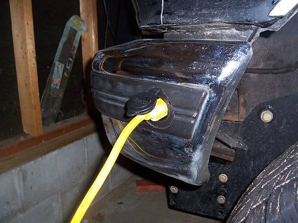

TJ & I relocated it to the bumper Name:  2750049440099659029S425x425Q85.jpg

TJ's way is the way to go IMHO.

Originally Posted by Action4478
TJ & I relocated it to the bumper Attachment 34921
I copied Mr. Rick's location...Marinco and I like it.

Yep, i used the marinco aswell...Except when i did mine...yea i realized that 97 was the first year a block heater was an option.........lol but the bumper plug looks great!
