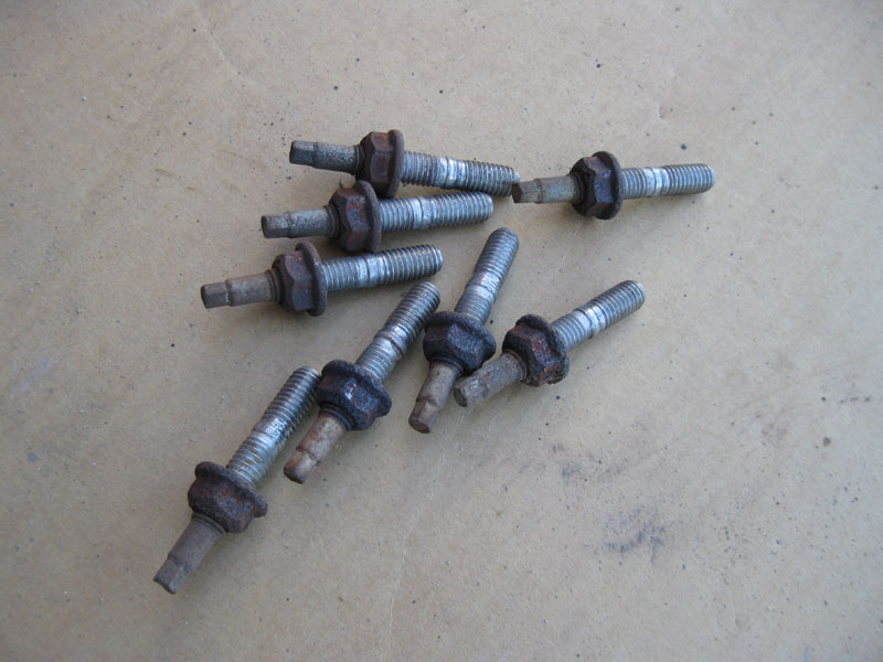

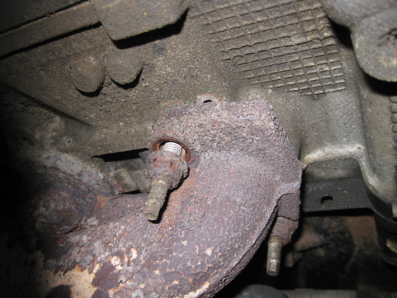

Besides, if they're anything like my 5.4L, the "good" studs will come out during removal (as opposed to just the nut coming off and the studs staying in the head). Like this:

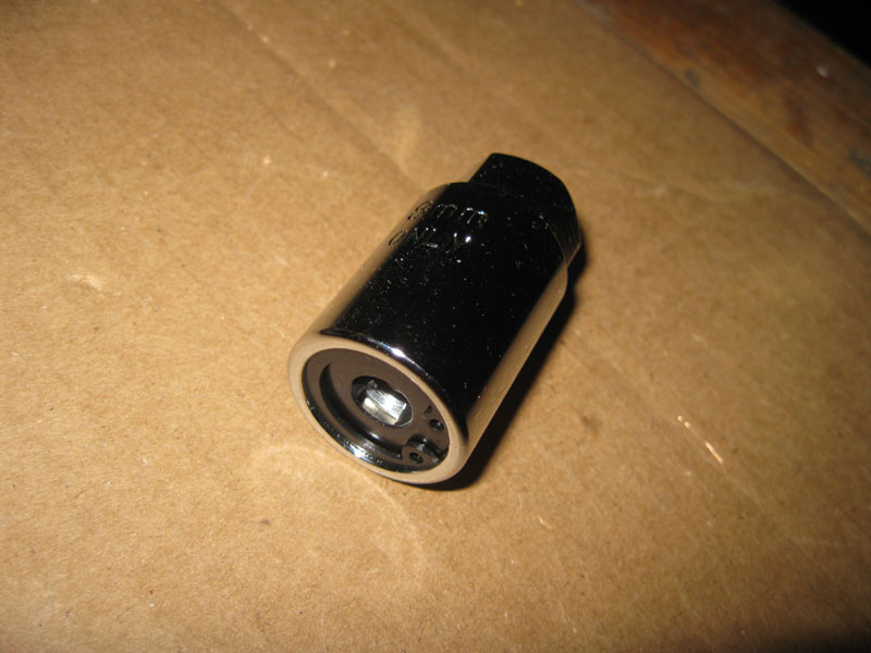

For the ones that are broke off, with some stud still sticking out, this tool works great for those. The tool is KD #41762.
I don't have any advice on replacement studs. I used the bolts that came with my headers. The thread size is M8-1.25 so if you can find some stainless hex head bolts the right length that would be good. Do you have a Fastenal nearby? They can get them. If not, you can order them from McMaster Carr online.
