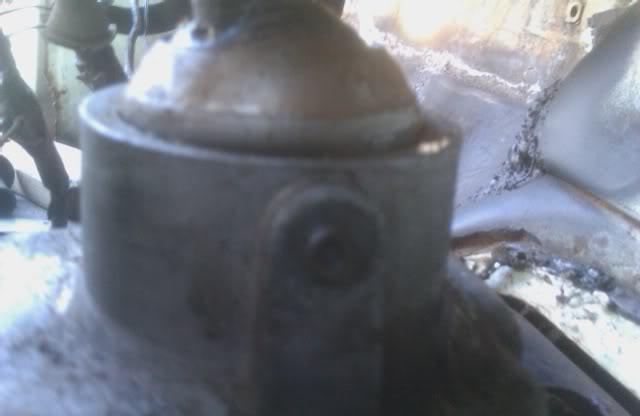

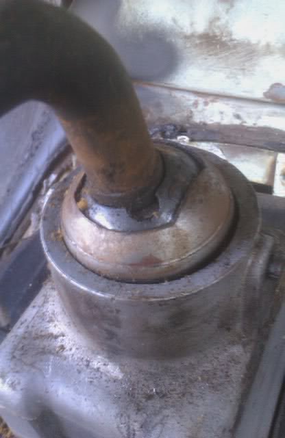

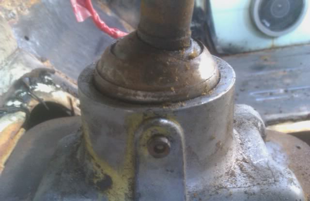

i'm taking out my 4 speed transmission and can't seem to figure out how you would remove the shifter shaft from the trans took couple pics does it disconnect if you take these pins out 1 on each side? can't get them to come out tried turning and pulling with vise grips with no luck.

DO NOT remove the pins.all you have to do is push down on the round keeper that is on the bottom of the shifter.it turns to the left as you are pushing down on it.the pins are what it locks into.

I went out and tried it and it worked I would have never guessed how this came off lucky I didn't get rough with the pins just alittle twist and pull figured there was a trick to it so asked before I damaged anything thanks for the help

Originally Posted by crazed87bronco
I'm taking out my 4 speed transmission and can't seem to figure out how you would remove the shifter shaft from the trans.
Took couple pics, does it disconnect if you take these pins out 1 on each side? No!
Attachment 229364
Attachment 229365
Attachment 229366
This is the New Process 435 4 speed. Its shift lever retainer cap has two notches, is retained to the shift tower with two pins.
To remove this cap, it must be pressed down by hand and held down while turning it counterclockwise to remove it.
People unaware use pliers or channel locks to remove it, which tears out one or both of the notches. Not pleasant!
btw: The Borg-Warner T-18 & T-98 4 speed shift lever retainer cap threads off/on.
IF the 1952 4 speed has 2nd, 3rd and 4th synchromesh, it's the T-98.
