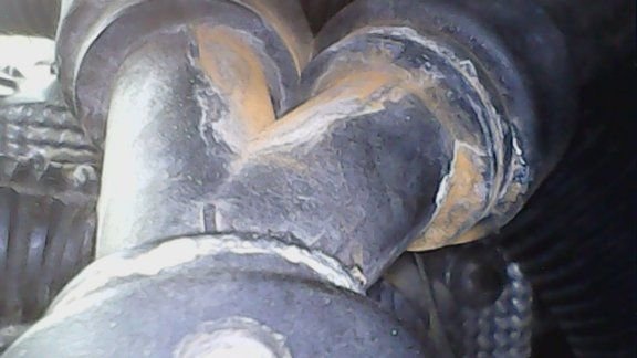

Here's a photo of the leaky, rotting plastic couplers:

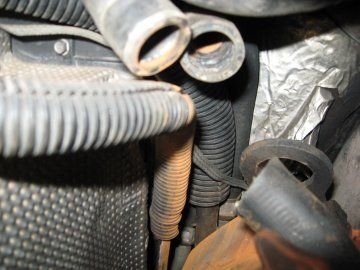

I used a pair of Channel-Locks, threw a Towel over the Couplers and crushed them out of the hoses:
Pointing the hoses downward, I cleaned out stray pieces of plastic with a pick...
Do one hose at a time, and make sure that crushed plastic pieces don't fall back into the hose (while crushing) by pointing down and using the pick:
Then the 'Y' fitting was installed:
Good Luck to all!

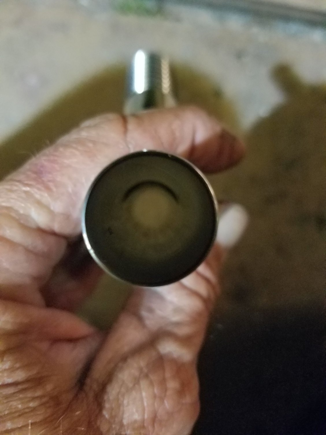

Hello everyone! I was checking to see how the Leader Stainless Wye fittings were holding up? I received mine and thought the wall was mighty thin...

Mine is perfect. It’s stainless, if it cracks there’s something wrong. Much better than plastic or cast aluminum and the perfect shape. Install it and don’t go gorilla on the clamps or use constant tension clamps and forget about it. I was the OG so if mine is still going they should be fine.

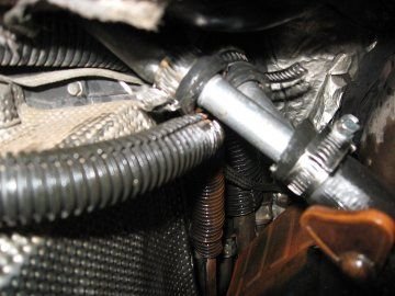

I made an account here to help out a few people reading this. I was struck by this problem in my 04 excurtion 6.0 and after seeing the dorman fix for $20 I jumpred on it but the Droman replair kit is 5/8th piping and the Excursion is 3/4. you may be able to tighten the livving hell out of it to make it work but what I found was a brass 3/4 x3/4 x 3/4 tee at lows for $5. they have both a barbed and sharbite that work (the sharkbite one is just a different barb and not a sharbike connector). that gets you back on the road same day. then I ordered a stailess Lateral Tee 3/4" for $17 online.
for the others adding copper and brass be aware that copper, brass,Steel and aluminum dont mix especialy copper and aluminim. I am a a netwrok enginner by trade and I have seen watercooled PC's that mix aluminum blocks and copper radiators tear themselves apart in under 2 years. It wont be fast but I also dont want to be destroying my radiator just for a cheaper fix. get stainless in there when you can or go back to plastic. sure plastic is why we are in this mess but I got 20 years out of it. If my truck is still on the road in 2042 I will be happy to put in another plastic tee.
As for removeal I didnt see alot of instructions. I saw mention of a dremil so thats what I did. I very carfuly used a cutting wheel to remove the plstic bands holding it all on only to find that the tee is so britle and the pipe is so stuck it want worth my time. I then crushed the whole thing with chanel locks and used a pick to pull all the peices out and off the walls. If I dod this again I would go strait to crushing it all.

Thanks for the reply. I went ahead and got the 3/4" 3 way T at one of the maple sugaring supply companies. I am glad after reading your post that I just went with that. It wasn't too bad of a fix (just awkward like everything else that should be simple). I got in there and felt where the nipples ended under the rubber hose an used a PVC pipe cutter that just sliced through the rubber pipe. I did this right where the nipple ended. That way I didn't need to try to clean the nipple out. It worked out well and has been going strong for a few weeks without any signs of leaks.
