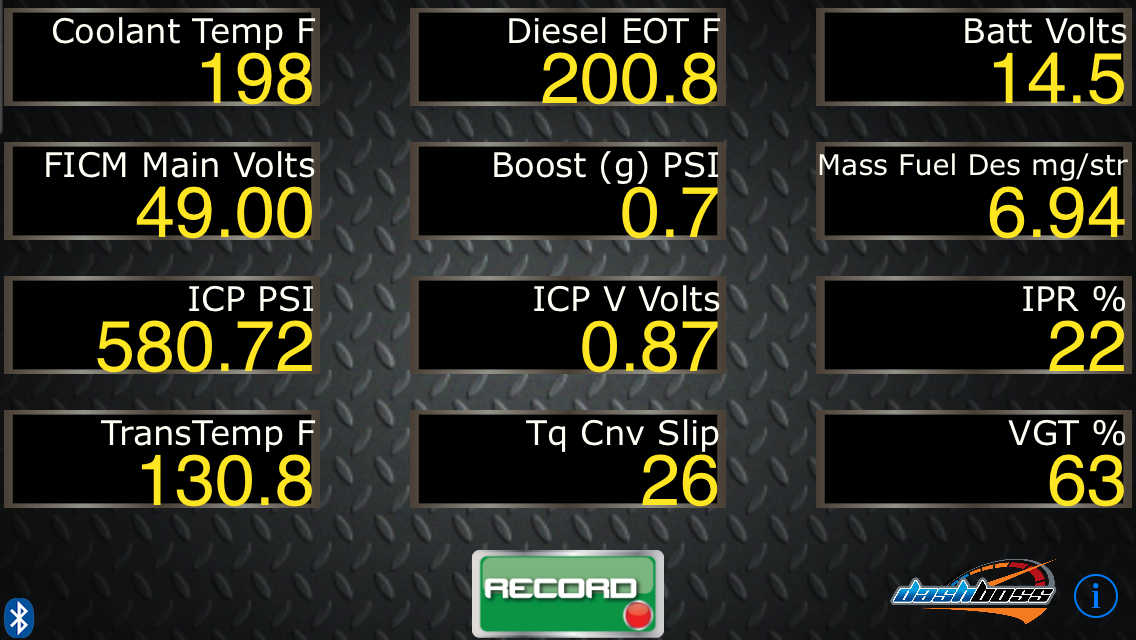

Originally Posted by Bullitt390
My Mishimoto is holding 199f with 0 degree temps.
Josh
+1 for the mishimoto t-stat. After my 2nd thermostat this year stopped holding above 186f in july, i swapped in the mishimoto. I see 202-204 in the summer with it and 200-202 in cold weather. If i have the heater turned up, it will drop to 196 at the lowest sitting in traffic. The truck seems to run better at higher temps. I was afraid it would run too hot towing, but it doesn't run any hotter than stock. It held 208 and only touched 210 (when the fan kicks in) in a couple steep grades. When i towed with the stock t-stat, the cooling fan come on a lot more often, albeit the ambiant temp was higher. I feel like the mishimoto opens up more than stock by 208.
